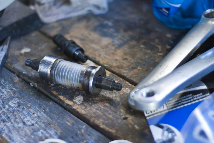

The Lockring came off pretty easily. Never realized how loose a bike it put together. The BB came out and I didn't even lose any bearings this time!
Saved me from having to search the garage floor... :huh
http://lh3.ggpht.com/_NUT3v0pNW04/TO...0/DSC_0009.jpg

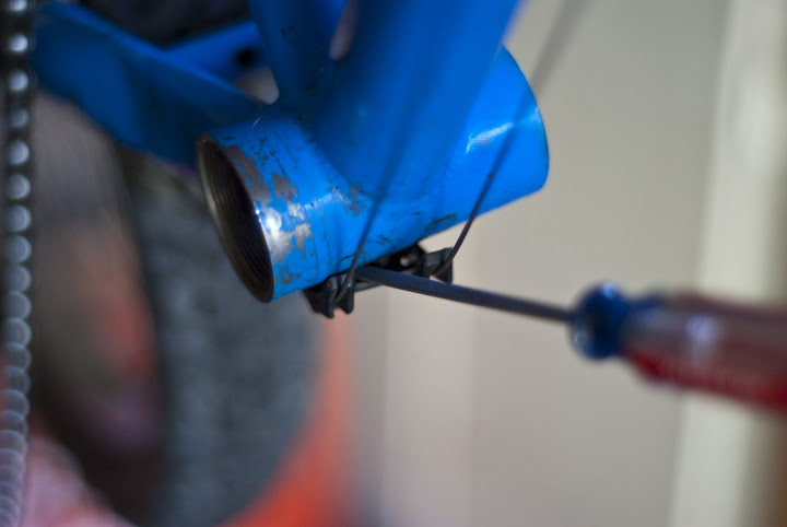

I did run into one issue. The bottom pull routing has a cable guide attached to the bottom of the BB. The guide is plastic with a screw that goes inside the BB. I removed the screw and pushed the plastic out so I could get the new BB in. THe BB fits fine with the guide pushed back in but the screw is too long so I'll probably just cut it so it's not screwing into the inner shield.

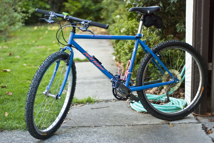

Getting the BB aligned was pretty simple since there are only 3 shims and it's obvious how they are arranged. It was very easy to install. I didn't bother getting the BB squared up. Since the gears aren't in the same locations as my originals, I had to redo the High and Low on the derailleurs.
http://lh5.ggpht.com/_NUT3v0pNW04/TO...0/DSC_0042.jpg
Took it for a quick spin and they are nice. I have to get used to them not being BioPace though. They are very smooth and no creeks or thunks! :clap I'll have to decide of I want to keep the 44T on there or put a bash guard on. For now I'll just leave it though.
Took another poser picture then went on a quick ride. I'm still waiting on the new cables so I can redo the rear brake. Those should come tomorrow if everything goes as planned.

Ya needta get the derailleur down where it wants to be. 3mm off the outer chainring.
Shift better among other things.

Good eye!
He is right, it will make a huge difference when the front derailuer is at the correct height.

Where do I measure the 3mm from?
