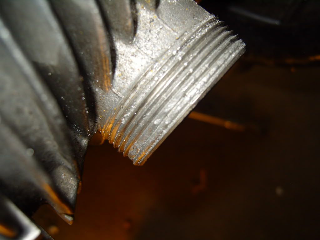

Started the teardown. Left exhaust came off fine.
The right side started to turn with the first whack, gave it a second and decided to cut off the nut.
I figure I will buy a new nut, clean the threads with the thread file and decide if they are too far gone or not.

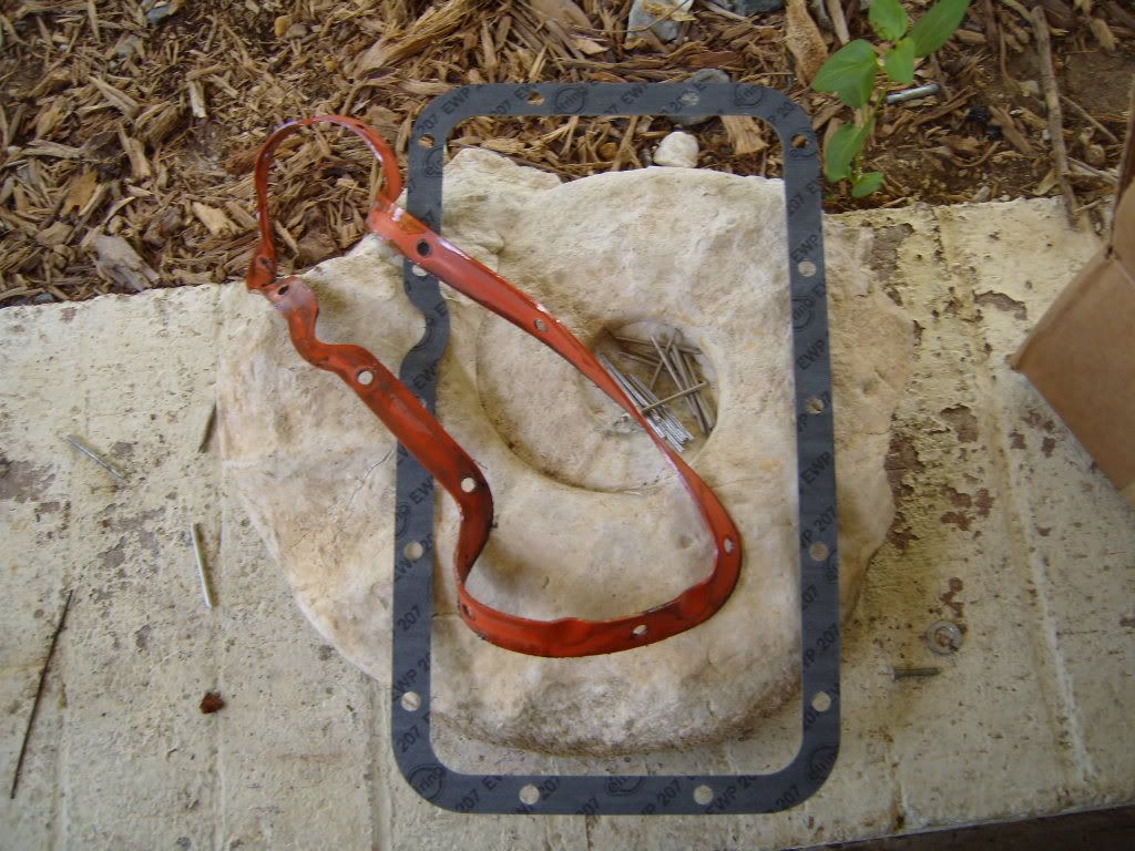

I pulled the old pan gasket because it was pushing out everywhere. The old one was a soft rubber the new one is more of a hard fibrous material.
At least the pan was pretty clean when I pulled it down.
