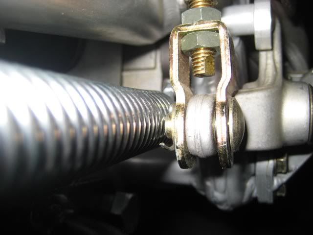

This is where longer bolt should be used. I include a longer bolt with a nut so that the spring is moved a little more inward.
So that the spring will not touch the clevis.

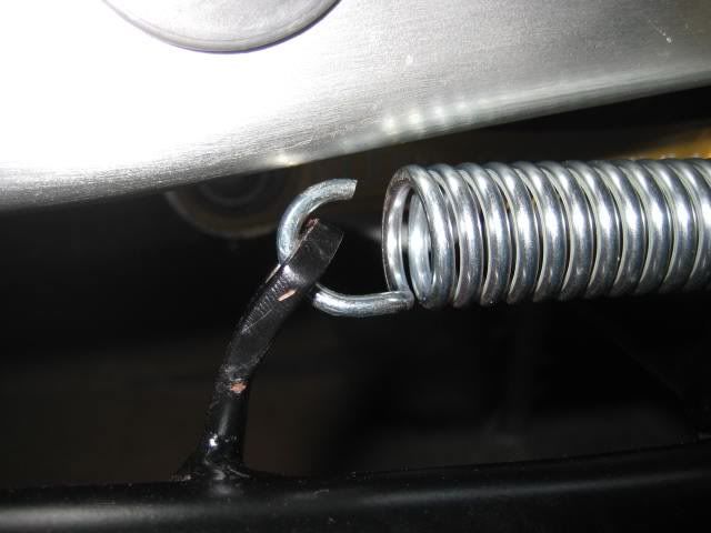

I will have to make an adjustment here for a non lowered bike. I think the swing arm would touch. I was trying to prevent...
this. But here is not enough room and will probably will be a bit more so that the swing arm won't touch the the spring mount in the up position.
