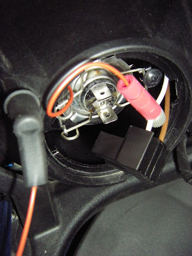

If you install the dimming control system that is triggered onto full power with your high beam switch then you have to tap into your high beam circuit. On my wife's 2009 650GS, the high beam wire is the white wire going to the lite plug. On my 2008 ABS Wee this is a yellow wire which is easy to locate immediately behind the either of your headlites. The kit provides a Posi-tap connector that easily taps into this line. The pic below shows the tapped-in connection on the 650GS.

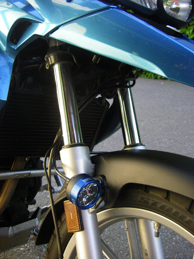

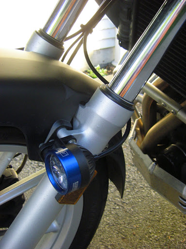

The lites themselves mount onto provided brackets that attach to the fender bolt in front of the forks:

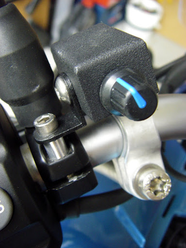

For the 650GS, the kit includes a small bracket to mount the troller beside the left mirror stem (see pic below). On my bike I just velcroed the troller to my collection of heated gear trollers that I have mounted on my left hand protector.

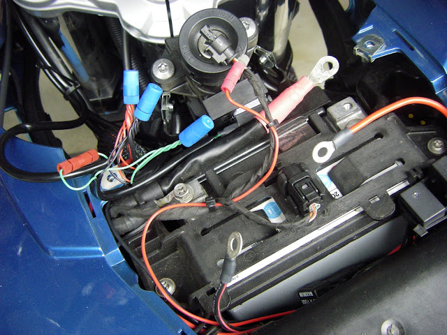

On the BMW 650GS, I velcroed the small high beam control unit (relay) to a flat surface immediately in front of the battery, and simply tucked the switched power relay and the CANBUS controller in the small space available behind the battery - its on the right edge of the following pic. The VStrom has lots of space under its cowl with numerous mounting locations.
After that it was simply a case of bringing all the wiring to a common spot and connecting all like-coloured wires together using the provided Posi connectors (above pic, on left). Note that the large blue marette-like connectors provided, unlike most Posi products, don't have an internal metal cone (its plastic instead) so all the wires going into the connector must be twisted together to contact each other before inserting them into the Posi connector. In the case of the two light-gauge green wires coming from the high beam switch relay and the troller I opted to use a different, smaller, in-line Posi connector that I had a stock of on hand because I thought the connector provided by Clearwater to be a little large for this particular connection.
After that, I just taped everything up to make all connections as waterproof as possible and tucked everything away under the cowl where it won't be in the way to ongoing maintenance of the bikes.

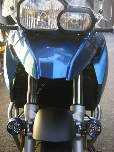

The lites look great. The trim rings on the lites come in various colours. On the BMW 650GS, we ordered the blue ring that is a close match to the bike colour. On my bike, they didn't have anything close to my bike's Daytona yellow, so I stuck with black trim rings.
And they certainly will get you noticed. The following pic is of my VStrom with low beams on, and about 1/3 power to the LEDs):
