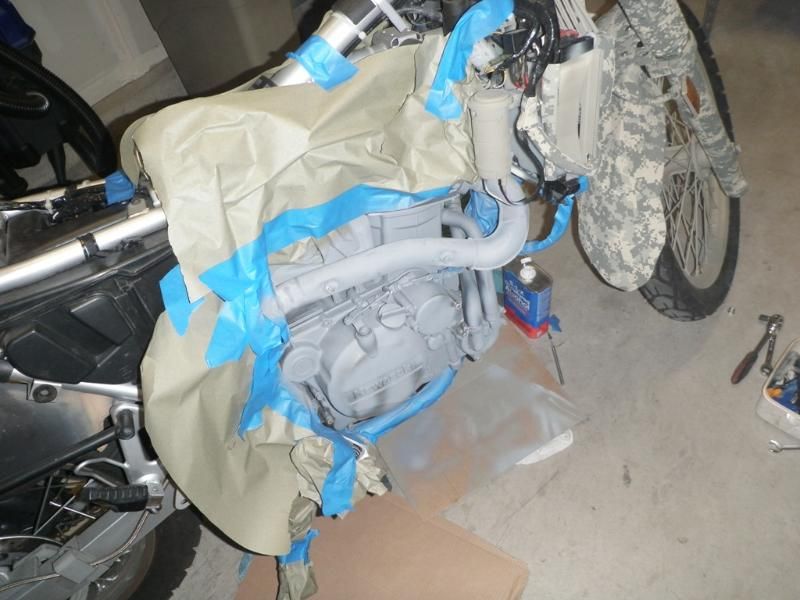

clean, scuff (with 220 grit sand paper), prime engine and exhaust with high temp primer
paint engine with high temp stove paint, sand color
paint carb, and exhaust
close-up of paint on engine exhaust
standoff view of progress

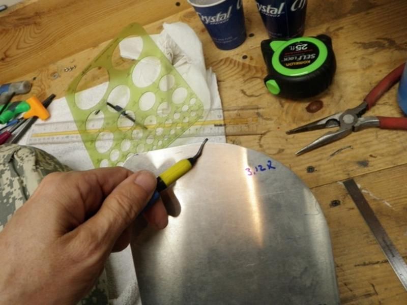

size the mounting panel needed
trim as needed
de-burr edges
good fit

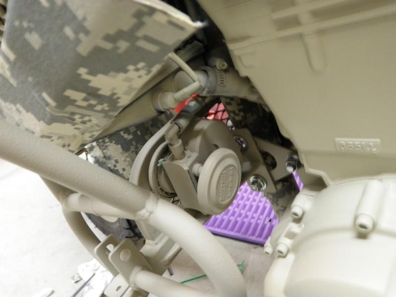

paint steel horn...notice the high pressure line. I separated the actual horn from the air source
the air horn mounted here
