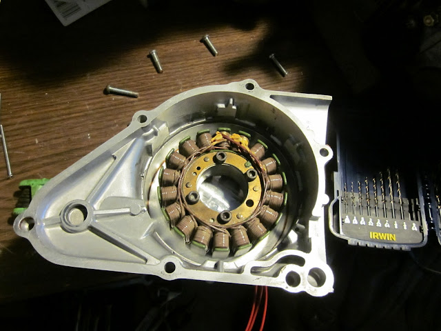

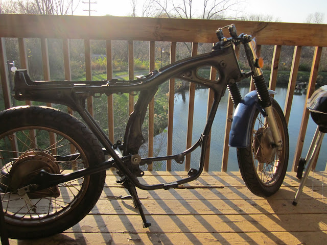

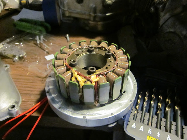

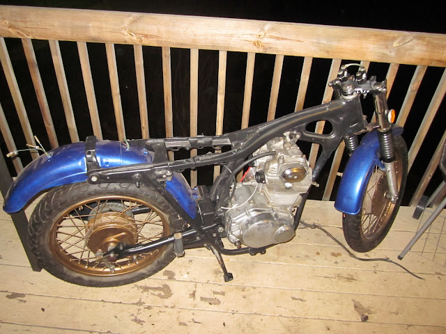

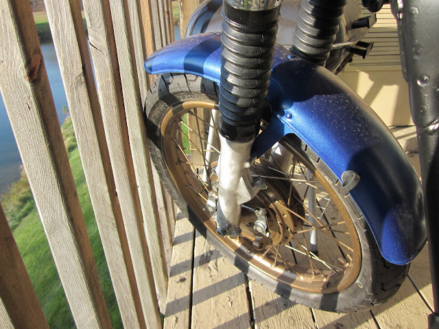

Its been a while, and stuff has slowly been getting done, but I'm starting to focus more on the CL350 again. A lot of stripping & repainting parts has happened, but not much that could really be considered progress. Anyway, as of this afternoon I started building the frame back up, putting on the front end, rear swing arm & wheels with new tires, as well as getting the engine back in the bike to start laying out the wiring harness. Some progress has been made on planning the harness, and the alternator should be all sealed up and ready to go. Charging the battery now to spin the engine over & just check to make sure that the alternator is centered on the crank's axis of rotation, and isn't going to scrape the stator.
Some more pictures of the stator setup:
And of the bike starting to come together:
