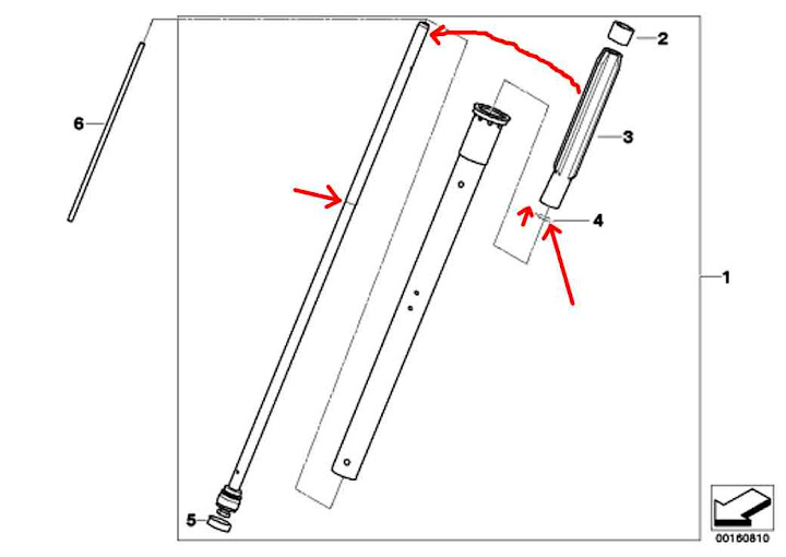

The fork clack noise/feel is absolutely without a shadow of a doubt not from the plastic x shaped spring guides that ride on the damping rods inside the forks! Those black plastic x shaped spring guides do not move on the damping rod, and do not make contact with anything other than the inside of the springs. I've been inside my forks 4 times. The black plastic x shaped spring guides "snap" into position on the damping rods as to not move. They don't move therefore do not hit the fork tube cap therefore do not make a clacking noise. I've marked up a parts schematic to point out the facts:
#3 is what certain people claim is the clack-making culprit. It is the back plastic x shaped spring guide. It has a small steel ring that sits inside it in a groove (#4). #3 with #4 inside it slides onto the damping rod. The damping rod, as you can see, has a groove where the spring guide "clicks" or "snaps" into position, FIRMLY. I suspect that there MIGHT be some forks that are coming from Marzocchi without one or both of the spring guides snapped into place. If you open up your forks and the back x shaped plastic spring guides move up and down on the damping rod, this means simply that they are not snapped into place on the groove on the damping rod. Snap them into place and you're done (it requires some elbow grease to snap them into place, but this is a good thing and how it was designed. Once they're snapped into place you will not ever have to remove them again. They should have been snapped into place at the factory). No little rubber pieces or other voodoo needed.
All of that said and demistified, I'd like to point out that I have gone for rides with both of the black plastic x shaped spring guides both unsnapped and loose on the damping rod and snapped into position. No difference. No change. Sounds and feels the same either way.
