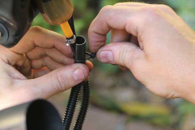

This is awesome, this is good. Fix the kink and we should be good to go. This explains why the fule pump won't buzz. The line is kinked and already pressurized. It also explains why when the bike when it does run feels like it's running out of gas. Ok, good. Now lets fix the kink. John at Rally Raid, http://www.rally-raidproducts.co.uk/ says this has happened to him before doing a tank install. He tells me over Skype how he fixed the line. You use pliers to get the kink out then you take a hose with a bigger diamater than the corrugated tubing and wrap it over the Kink. Apply small zip ties over the rubber hose and the kink is fixed.

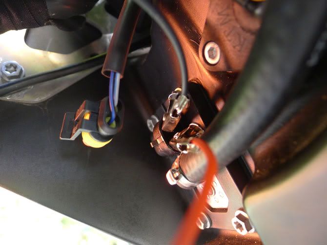

Nope, around the 1 1/2 minute mark the bike start to drop RPM's and stalls from lack of fuel. We are back at square one. Now I install the pump and attach the alligator clips to the electrical lines comming from the pump directly to the battery.

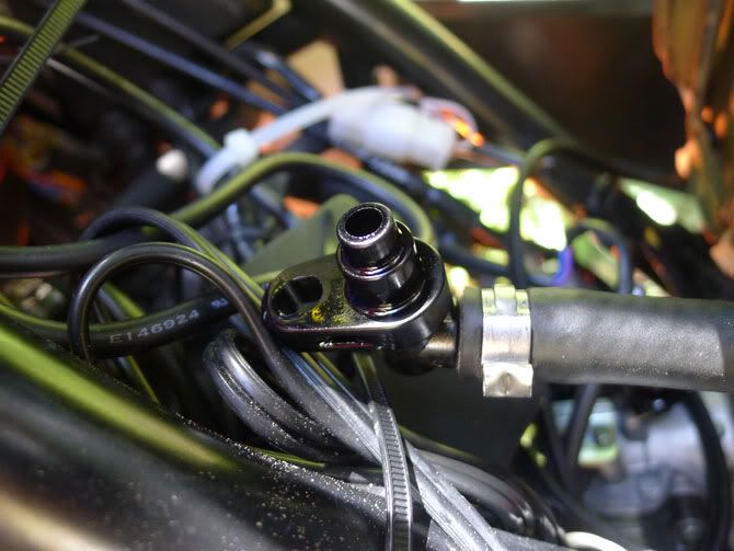

I then pull the fuel line right before the injector on the fuel body.
I connect the other ends of the alligator clips to the battery and watch the fuel flow. It is a strong constant stream. There is plenty of fuel pressue. Hmm...I start the bike and it dies again in 20 seconds. I pull the injector out and watch it shoot an intermintent spray of fuel. Everything looks good there too.
