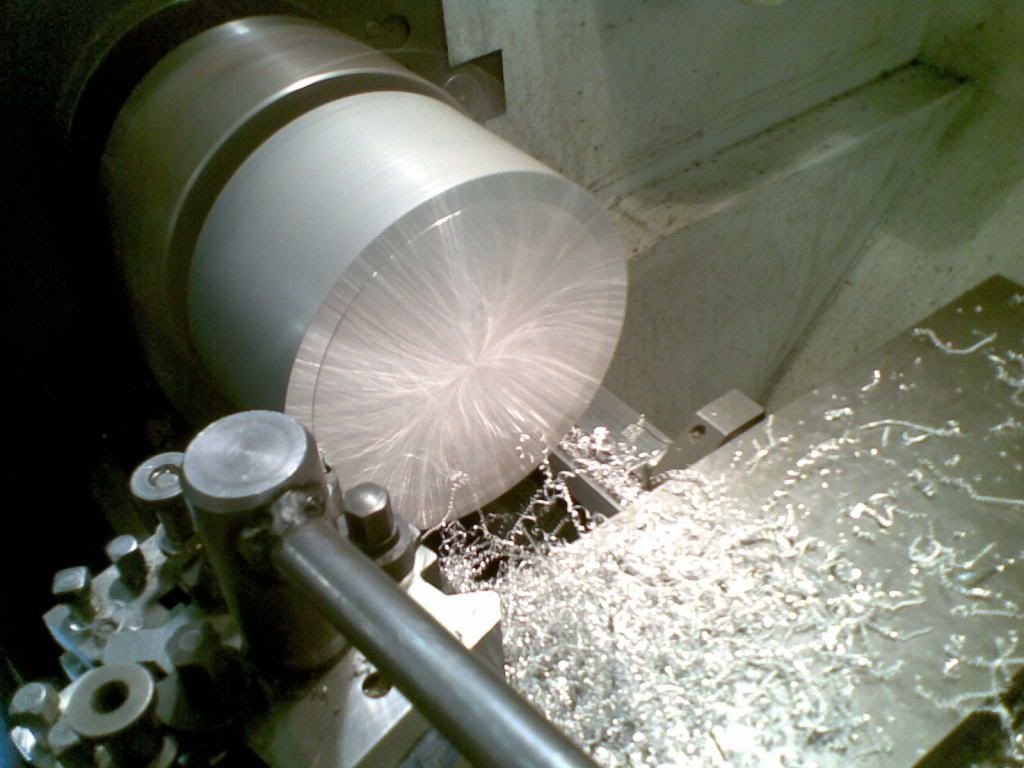

So I did some home work and found out that the talon and rad hubs are made out of 6061 t6 aluminium. I went to get a quote on a piece of round 6061 bar 180 dia x 100mm long and low and behold $55.
so
We go from this to a carrier over the next week or so

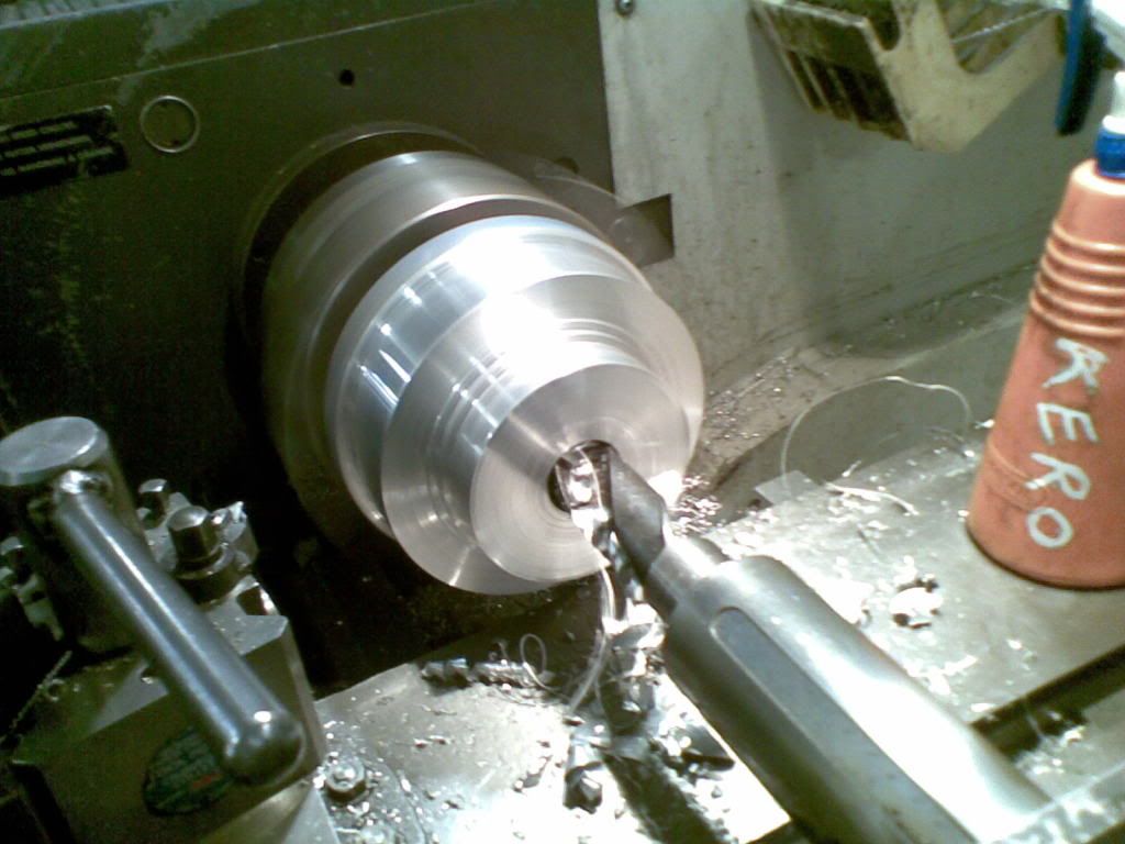

So after a bit of material removed ready to drill
That is an inch and a half drill bit (38.1mm) and i have bored it out to 40mm and added the inner taper to match the angle on the inside of the fingers of the carrier.
So here they are sitting back to back and the next step is to part the excess, below the blue mark(somehow?), then machine up the face where the sprocket carrier sits and the bearing pocket on the lathe. Then hit the mill with a dividing table to make the fingers.
