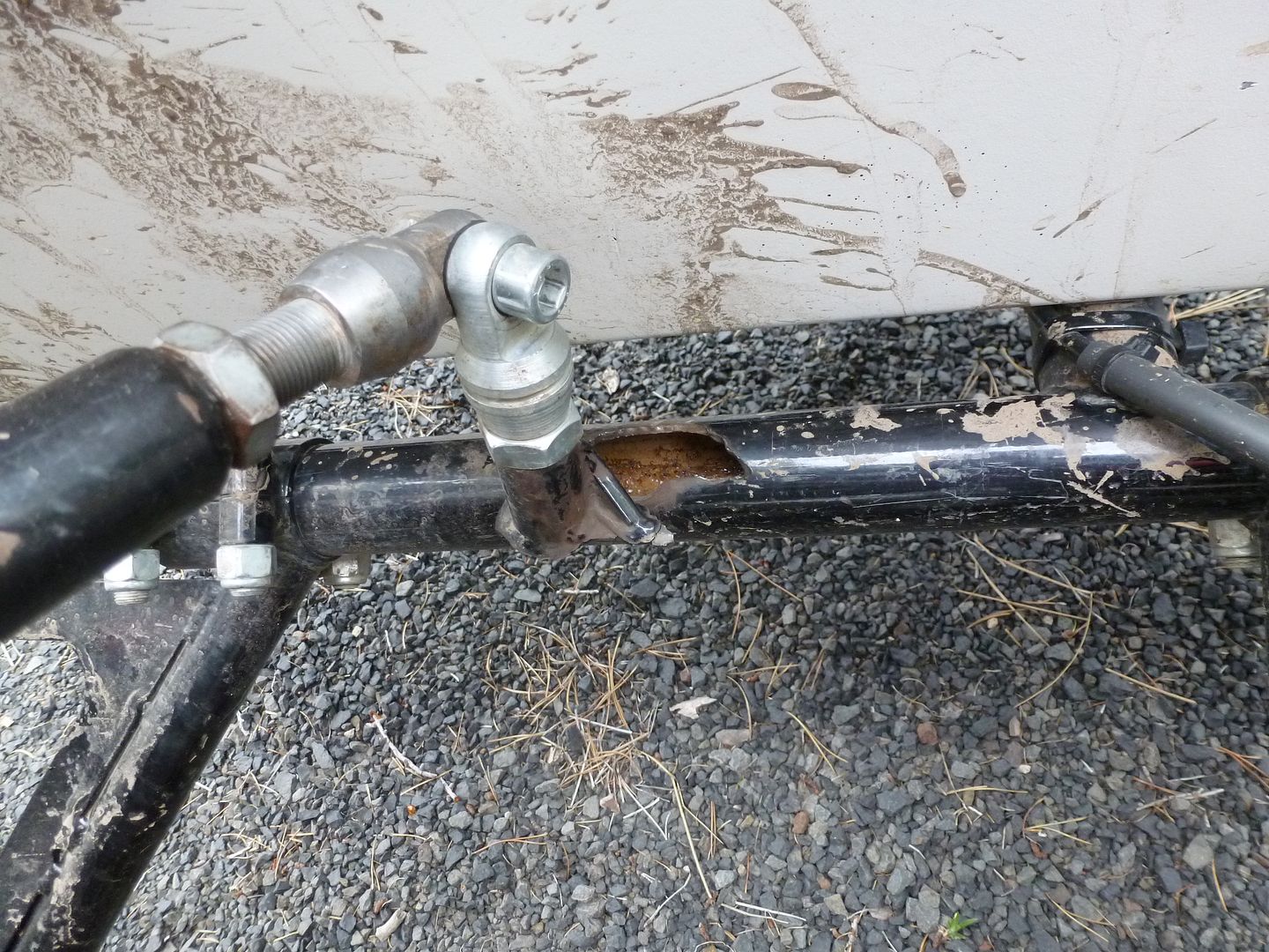

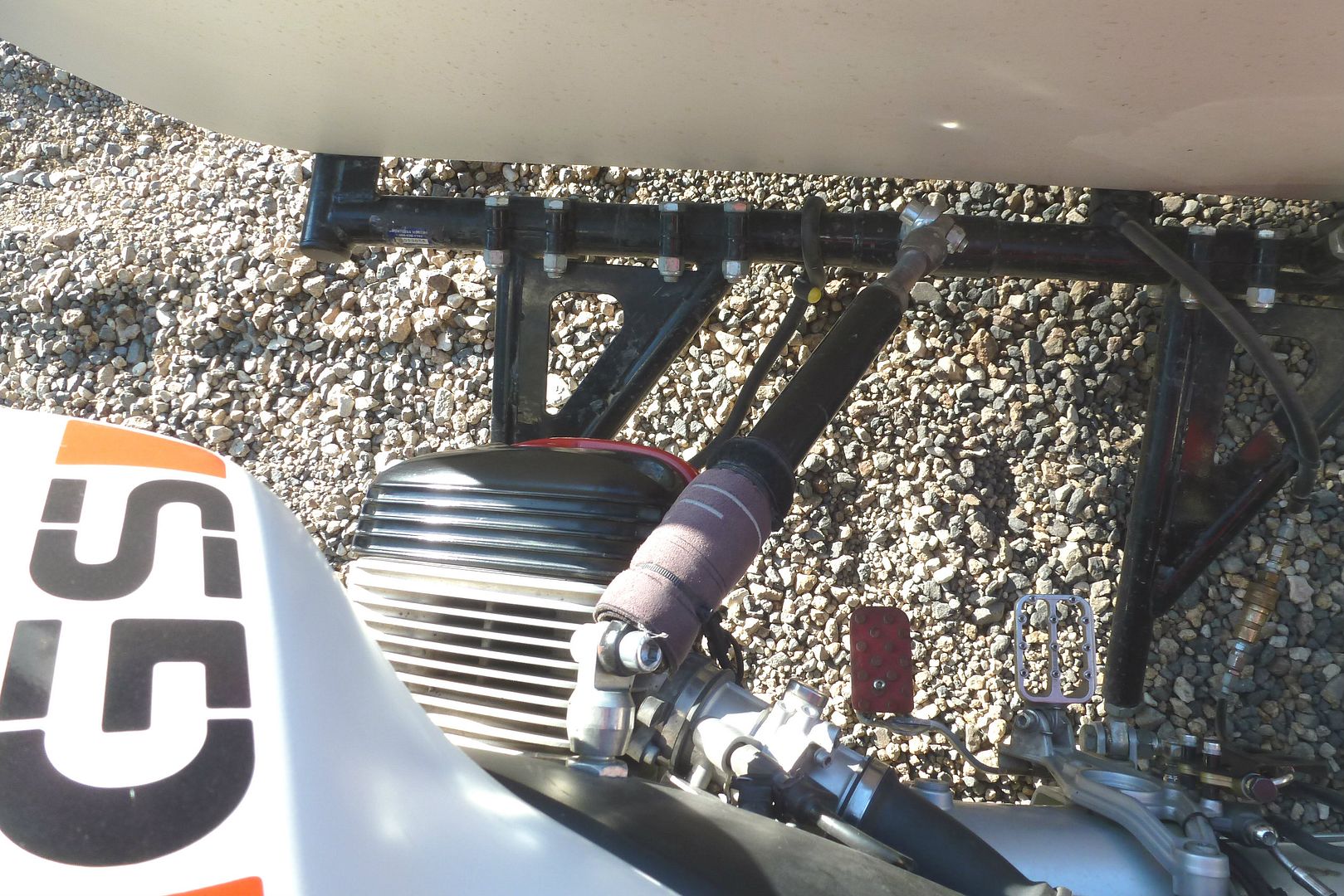

Edit--Yeah, it did break, in June of 2012 after maybe another 10,000 miles, many of them on dirt and gravel. This rig has not been babied! Here's a pic--
But the struts are pretty robust. I had no trouble driving another 300 miles with the broken strut to Enumclaw where DMC was able to fabricate Jay's retrofit solution for this problem. Sorry for the bad pic--
Basically, they weld a collar around the frame then drill it and weld in a solid mounting post that's welded on the top and bottom of the frame. Much stronger than before.
In defense of the DMC design, I must mention that the P.O. had mounted the car totally wrong (both lower struts upside down) and the frame got 4500 miles of abuse before that situation got fixed. Jay told me that the upside down strut mounting put extra strain on the upper front strut, and he warned me to keep a close eye on it six months before iHop mentioned it in the post above.
