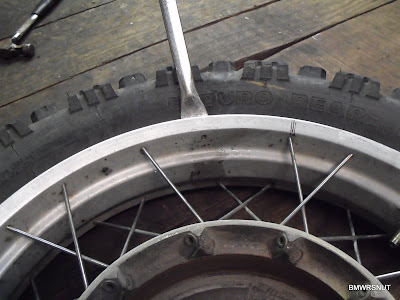

I also replaced the bent spoke. This was fairly easy. Soaked the nipple ends in WD40 for a while, to allow them to break any hold corrosion had on them, and to allow them to move more freely. Went to remove the grub screw (2mm allen key req'd) in the hub nipple (which uses a 5mm), and it actually moved the whole nipple. With that out, cut the spoke to make it easier to remove. Deflated the tyre to give me room to remove it. Put a tyre iron between the tyre & rim to push the tyre wall back, to allow the spoke to come out cleanly, then drifted it out.
Cleaned out the spoke head seating area on the rim, and also the nipple area on the hub. Used a bit of moly grease to ease the seating & stop corrosion.
Tightened the spoke from the hub end. Used a punch to ensure the spoke head end in the rim was seated well. When I was satisfied the 'pitch' of the tensioned spoke was the same as others running the same way, I put in grub screw back in & tightened this up. All done.
