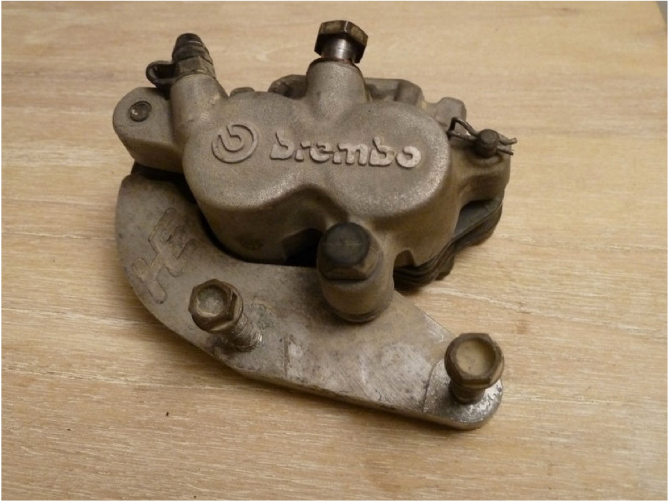

here is an old HE adapter to move from 300 to 320mm (wouldn't fit my forks but would fit Solo's)
HE sell this for 75,63
KTMax sell it for 105,50
http://www.ktmax.de/show_product.php?products_id=244
