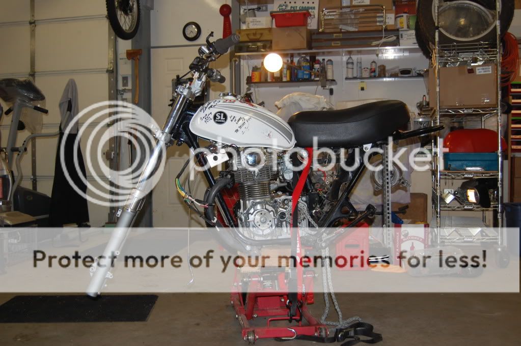

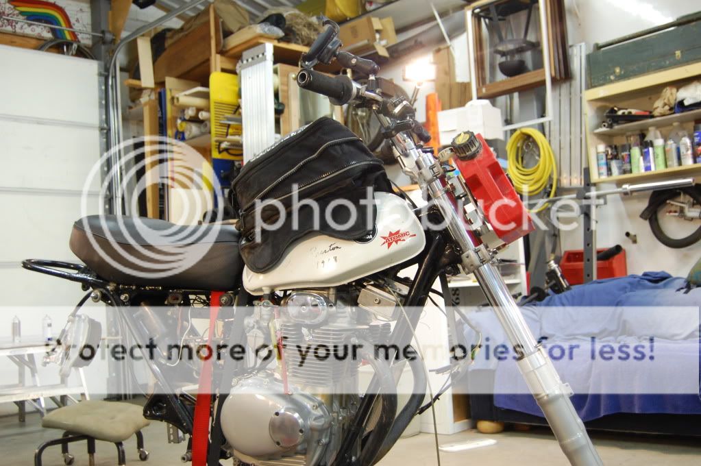

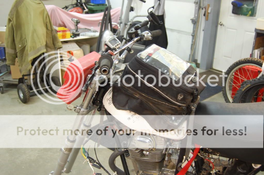

After the boys left I had some time to just futz around with the bike. This is some of my favorite things to do. I get to work out some ideas or thoughts about the bike, without the pressure of "getting things done" when the boys are here to do work. So, I threw on the forks and handlebars, tank and seat on and played around with some of my auxiliary fuel options for this years M1K.
With the Acerbis in the tank bag...last year we had MSR cans in there. Note the Day 2 map in the map holder...and that is real baja silt on the tank bag and roto-pax as they have not been used or cleaned since last year
