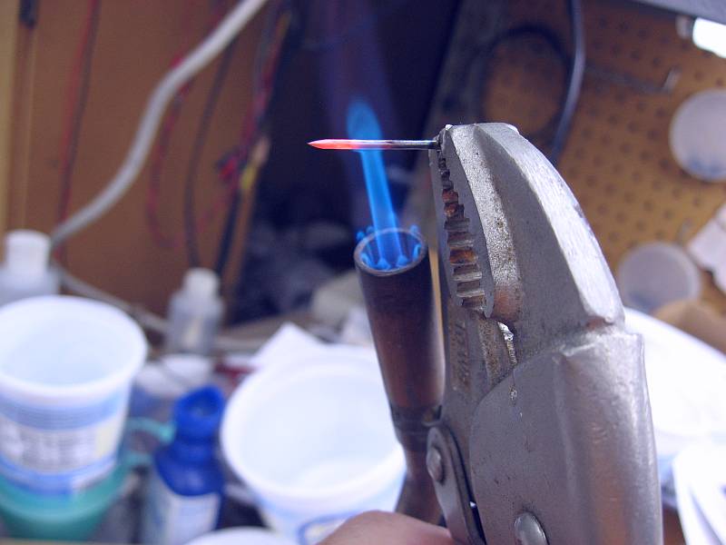

These pics show the preparation of the vial that forms the waterproof chamber for the jumper pins.

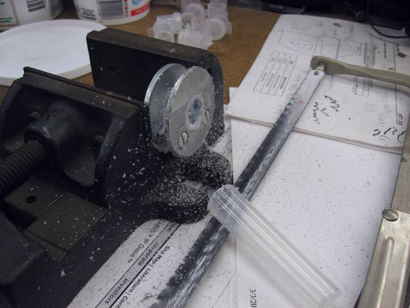

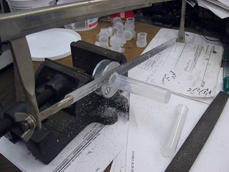

The vial is cut to length
A holding jig and a fine-tooth saw blade

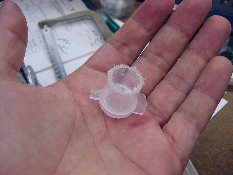

Cutting the plastic with a saw leaves some burr

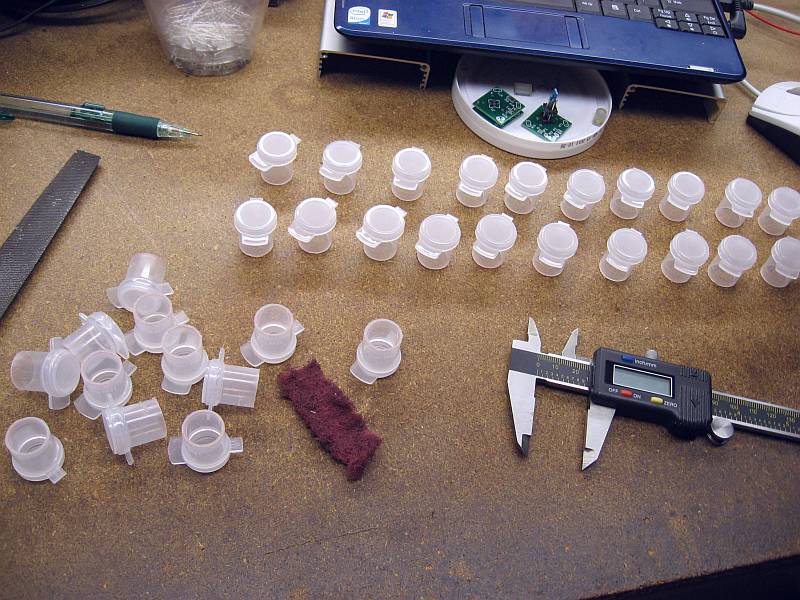

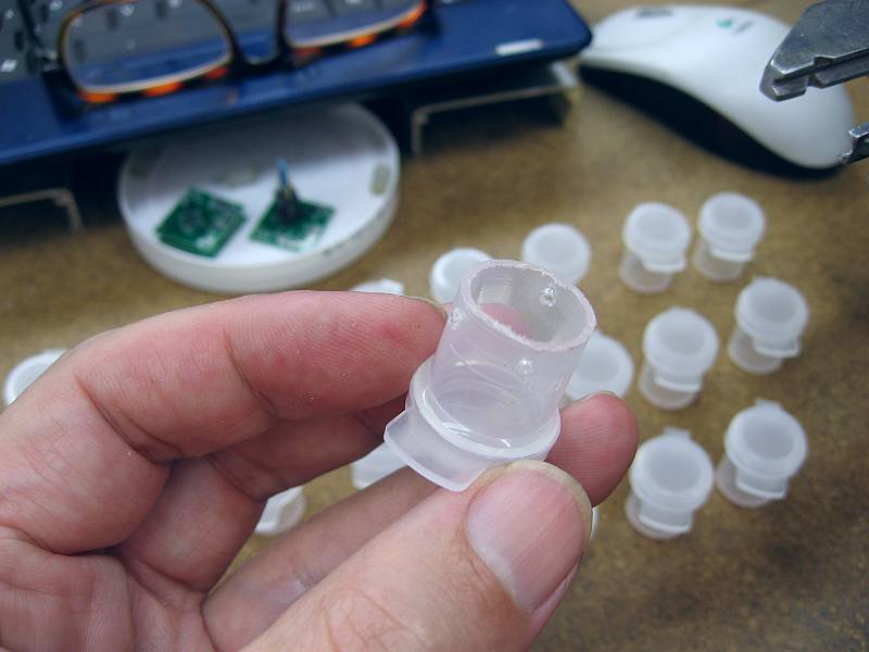

Deburr with a strip of Scotch-brite pad, then check the finish length

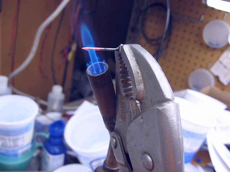

The vial needs a few holes to use as tie down points
A small nail heated to red hot is a good tool for this
These holes are used as tie down points
