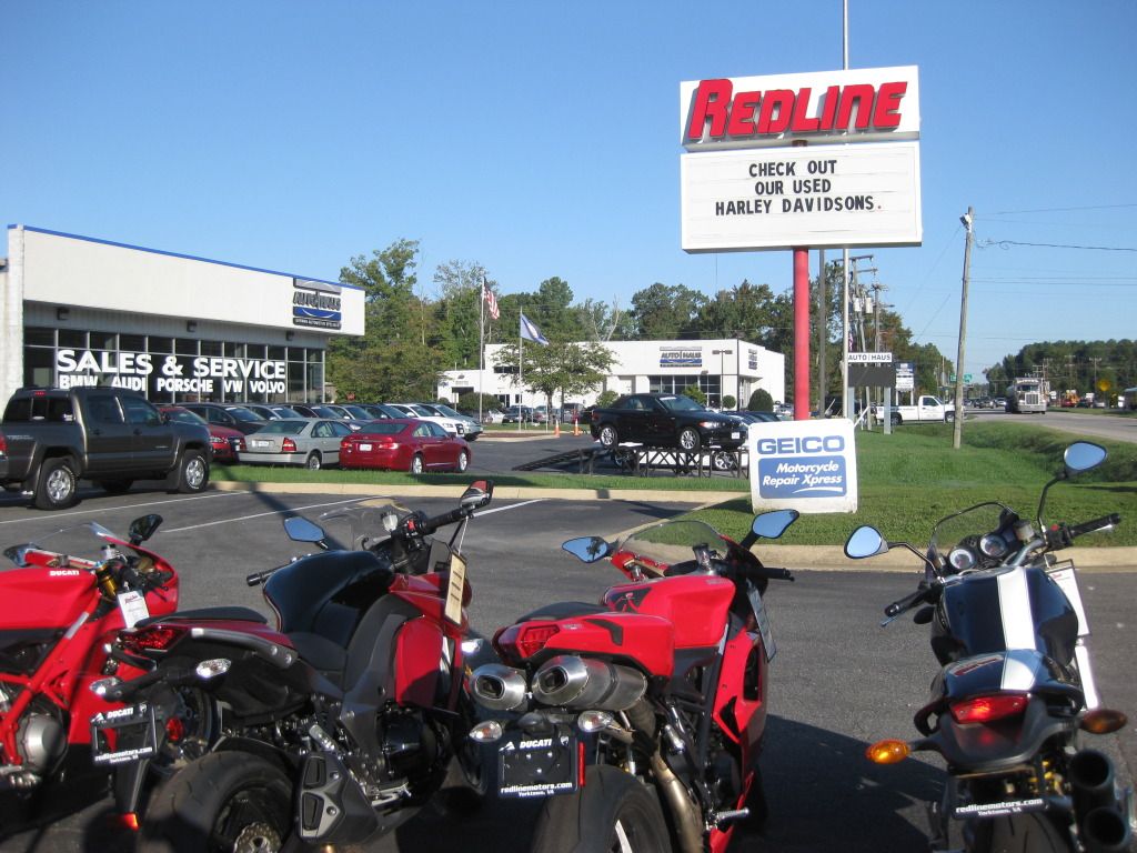

And WHUMP! Banged thru it and GB went into her bad running routine. Noticeably more vibration thru all ranges.I got to a motel just down the road from Redline, unloaded and gave the girl a well deserved wash at a carwash.
Left her for the full next day for service, tune and tires.

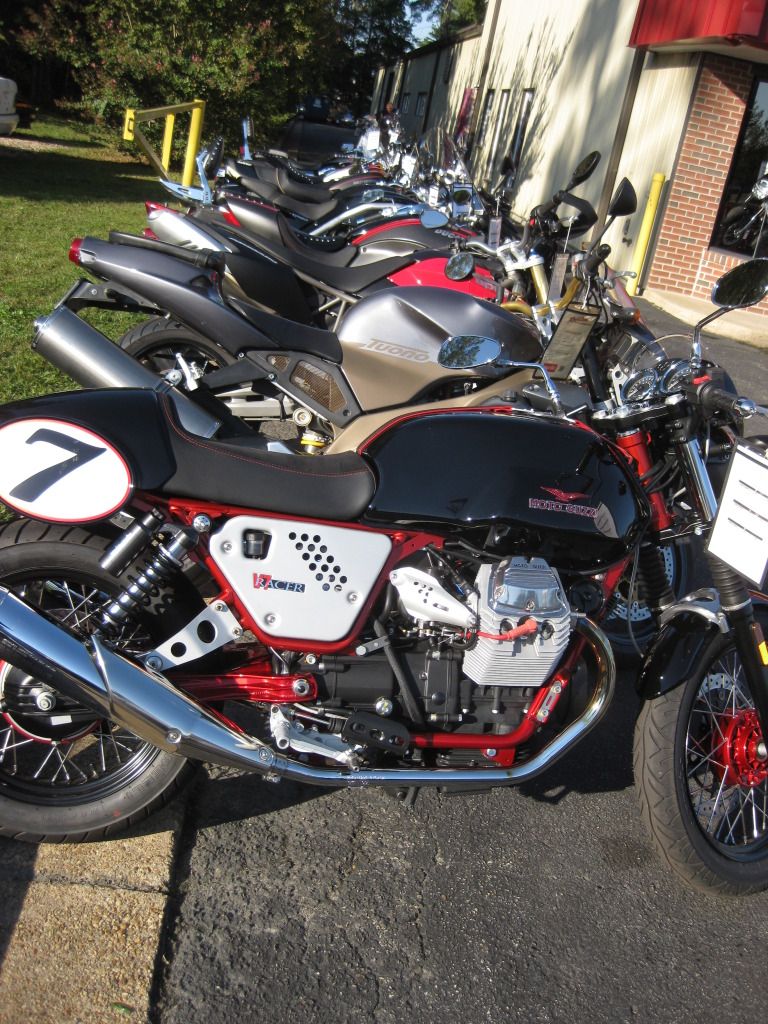

This place has quite a large inventory of awesome bikes.
Picked the bike up at the end of the day with some good news and some bad news. The PR3Trails have quite a different tread pattern and take a bit of getting used to. There was water in the front bearings and I can only hope it came from the pressure wash. They are recommending bearing replacement. The front tires was the cause of my wobble and not the rim. The discs however at warped a bit. Couldn't get rid of the decel pop because one of the two into one points on the exhaust has a leak caused by someone pulling it apart and damaging the gasket. This had to be the factory guy because they have never been apart. It is also something that has been bugging me since I left and I wish they had offered to repair it. Pretty easy fix, by the look of it. Undo the right header and pull out of the clamp, clean out the mess and replace with the proper gasket. Just need to find one. They even said the lower shock tubes have play in them and are recommending seal and bushing rebuild. The ECU remap has the bike running cooler (beneficial for when I get to that hot weather, wherever it is,lol) and smoother thru all ages. I feel it has lost a bit of its raw power that really came on in the higher rev ranges. When I used to rejet carbed bikes for a richer mix I would also notice this loss. But I am sure this is adding longer life to the engine. They found the sync and TPS out of whack so I am really feeling that all it takes is a good smack. not a good thing for a supposed dual sport bike.
