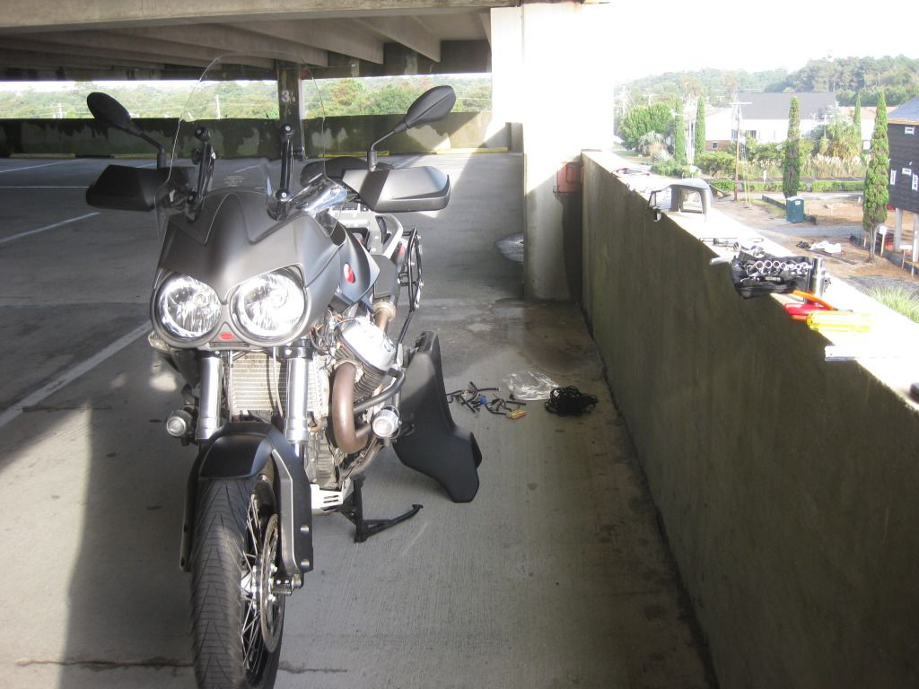

Then BG decided she didn’t like the way some of the boys had been messin with her and, luckily for me right in the hotel parkade, she stalled and read out the red triangle of death on her screen with ECU in big letters and an unplug icon. I just got a quick electronic rattle when I tried to restart her and, as it was getting dark I put her to bed and proceeded to drink alcohol which I don’t usually do much.
Wild ideas were going thru my head. What if the ECU is wratched? Nearest dealer? 400 miles to Florida. Rent a truck? Drive her there? By the Gods, why me? Was the Big Gal warning me? She would almost stall after gearing down to a stop. But that big momentus flywheel kept her going.
Side cover off in the morning. See if it really disconnected.
And there she is. All apart. Bright and early. Soon as I took the side cover off I saw it. Ground connection was loose. I put a wrench to it and it would not tighten any tighter. I removed the bolt; saw that the hole was thru drilled and put it back in. It would not seat. Was wondering if Redline had left a spacer out. It was within 1/16th” of seating. I stold a washer from a body part and got it seated. Fired right up, problem solved. I did, however pull it off again and retry seating it without the washer which, this time it did. Go figure. Redline should have checked the ground for tightness but in all fairness I might have missed it myself.
