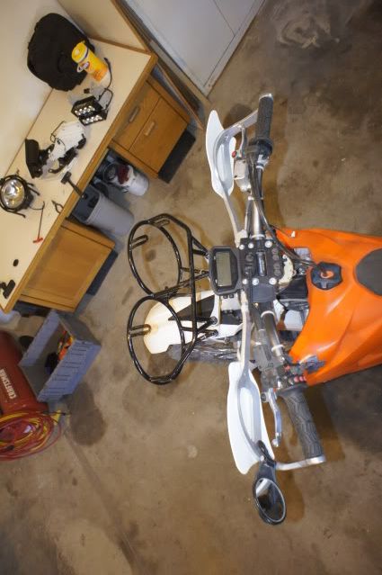

The last few weeks I've been working with cross-country to rig up a frame mounted light system for the Baja 1000, this is what we came up with. Starts with the frame mount, using 3xM8 bolts that has a fitted tapped stainless steel backing plate in the steering stem. Also has 2 side hole to bolt up, but we've found they weren't necessary.
With single 8"HID and 2 Squadron LED's
On the bike.
The double 8" HID's are interchangeable
That is very very cool!!!!!
I have the dual BD lapaz HIDs and also a squadron.
How does the squadron compare to the HIDs for throw and general lighting?
I've only used my dual HIDs once but the light throw out is ridiculous - gave me a 1.5km range!!!!
