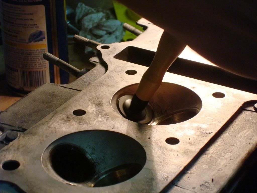

As you all saw, just in the nick of time and despite my best intentions, Rick explained to me that a cold chisel and framing hammer weren't the proper duo of tools for doing valve work. He then showed Luke and I the correct technique of lapping in valves with the time honored suction (sometimes) cup-stick-thingy and black, wet volcanic sand-like valve lapping compound:
After all of the pits were worked out and we were left with the tell-tale consistent light gray stripe on all eight valves and seats, we moved onto the bottom end. Luke discovered that the ignition side-cover wouldn't fully seat onto the crankcase, so

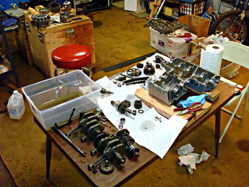

Next up was some more wrench-spinnin', circlip removin' and case crackin'. Here's a photo of the bottom end completely disassembled with all of the parts ready for cleaning, inspection, cuss-mumbling, and reassembly:
Besides a bad bearing surface on the end of the primary transmission shaft (which was replaced with a perfect spare shaft from Luke's spare parts stash) everything went smooth as can be, but there's much more to tell...
