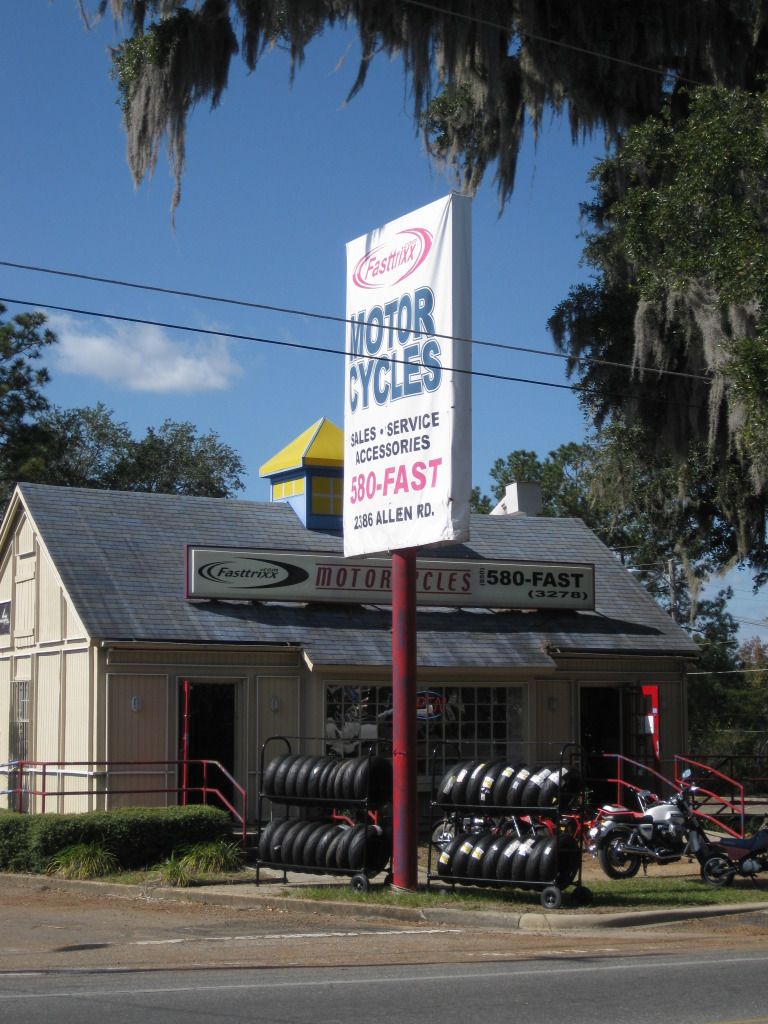

Made my way to Tallahassee and Fasttrixx.
Met the owner/MG tech, Danny.
Who turned out to be a one on one type of guy who was and still is determined to to get to the bottom of my troubles.
He actually found a connector I had installed when I removed the air system, had been lying against the cylinder out of sight, and had disintegrated, allowing air into the TBs. He found the sync still spot on and got an immediate improvement in performance. I had replaced the tee connection with a plastic nipple, joining up the two existing rubber hoses and keeping the TBs connected. What I didn't know and couldn't see was the position of the connection. My bad.Danny also enquired and listened to my rant on deficiencies and warranty issues and went after them. As I had said I wanted to hole up for a while not to far away from there, he suggested we deal with these issues now. Agreed.

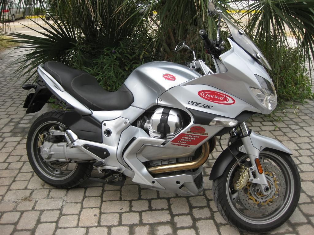

Putting around PCB I was finding BG even trying to stall when I would come up to a stop. I figured it had to be the airleaks in the exhaust so I pulled it all apart and, using the permatex copper, gooped everything double time and tried to make ad hoc gaskets (which weren't there) for the header to cylinder mate. Waiting the whole 24hr curing time, I tried it out to find a not perfect but noticeable improvement. On the second morning I decided to, once again, check the valve lash. I found a small need for improvement but just a little. That done, I rode thruout the day to find my improvements just steadily decreasing. Called Danny back and he asked me to get it back up there and leave it. And so, yesterday, it was back to Tallahassee and back to here on a loner.
The Norge was a nice ride but with my arthritic knee and shoulder, a painful one. So, here I sit. In comfort. With Danny bound and determined to get to the bottom of this. I cannot say enough about this guy. He's going the full nine yards for me and I can't give him enough credit.
