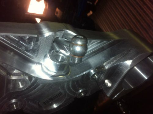

I shouldn't need to say this but this stuff will be your best friend during the install!
MAKE SURE YOU USE BOTH COPPER WASHERS

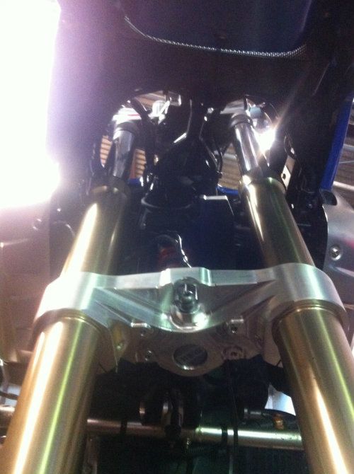

Forks go in
An upskirt shot......

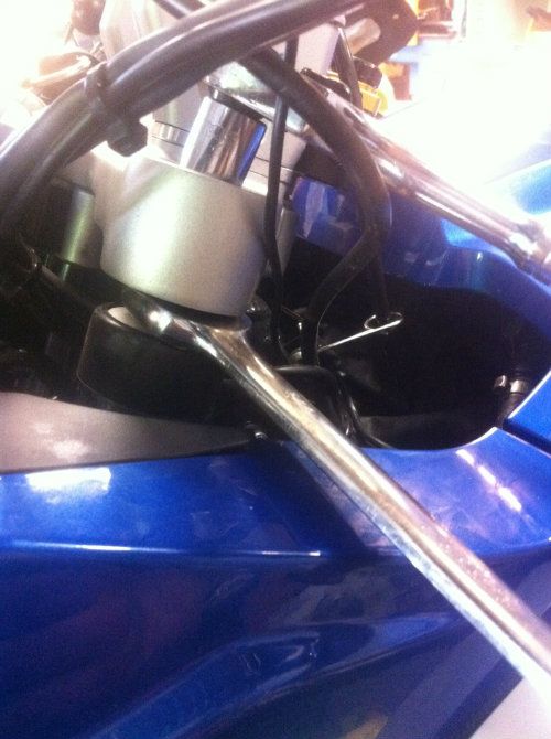

Tighten the tops of the forks

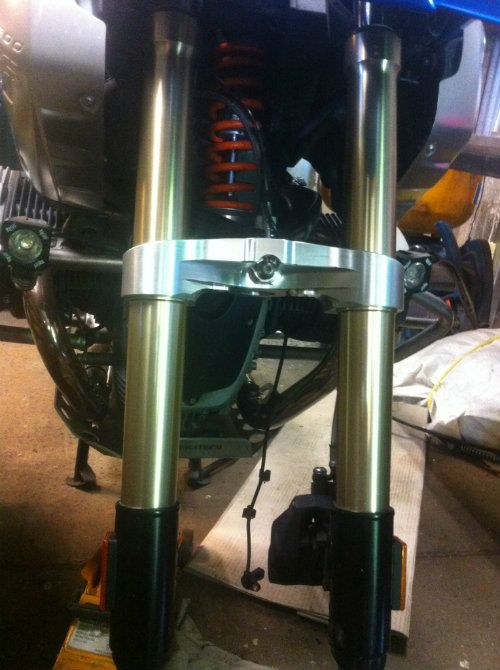

These are random pics of the installed clamp.
First off, sorry about the quality of some of the pics, they were taken on my iPhone, but it still gives you the idea
Now its time for Quirky to come grab the beast and get riding!
