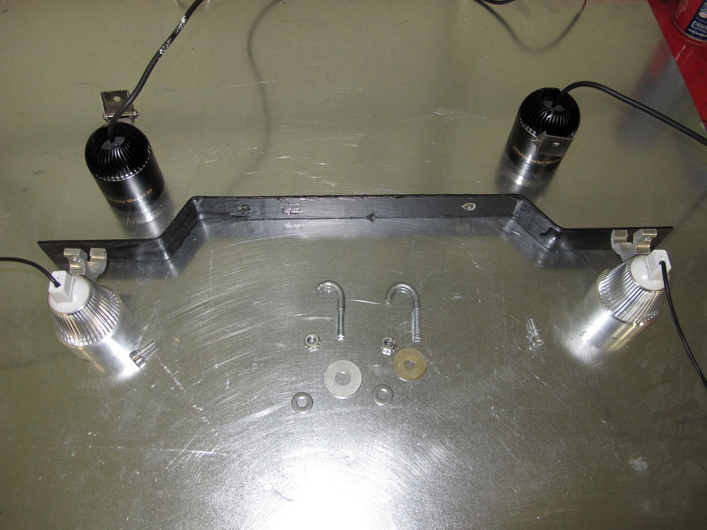

Using 1" by 1/8" flat bar I formed this:

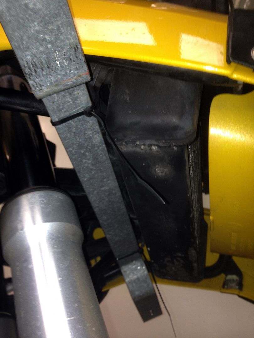

Checking for clearance I zip tied it in place.
The center section is 11" long, with a 1.5" drop and 4" mounting surface for lights. It is quite stiff as is.
Being cheap, I made my own "J" bolts from long bolts I had in the bin.

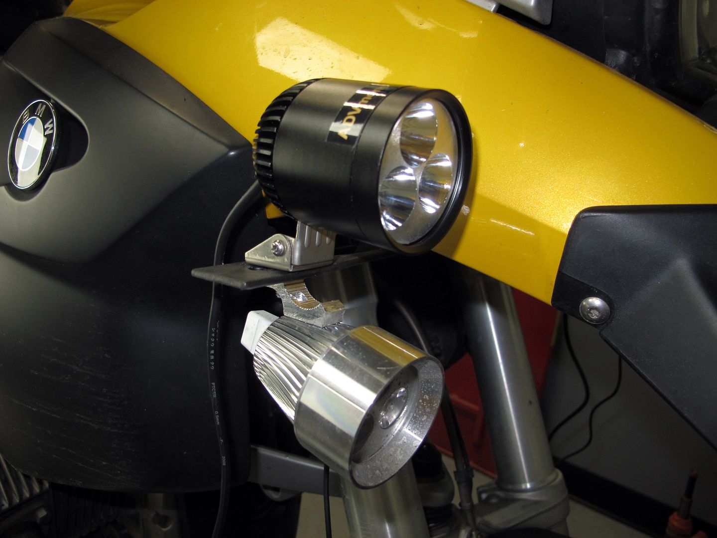

Mounted to the beak frame with J-bolts. As far forward as possible. This gives the forks about an inch of clearance at full lock.

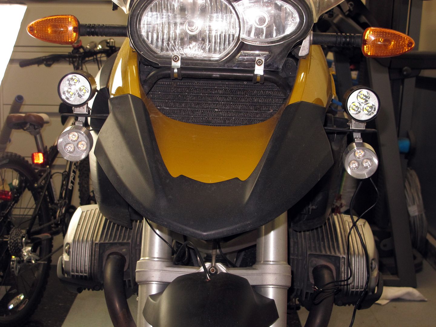

The conspicuity lights are mounted low, and the driving lights high. (Yes, I would have prefered black light housings for both, but they were cheap.) I used the same bolt, loctited, for both lights.
Front view. Looks like this should work great!
