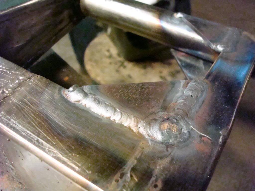

Another view of Luke's TIG Welds:

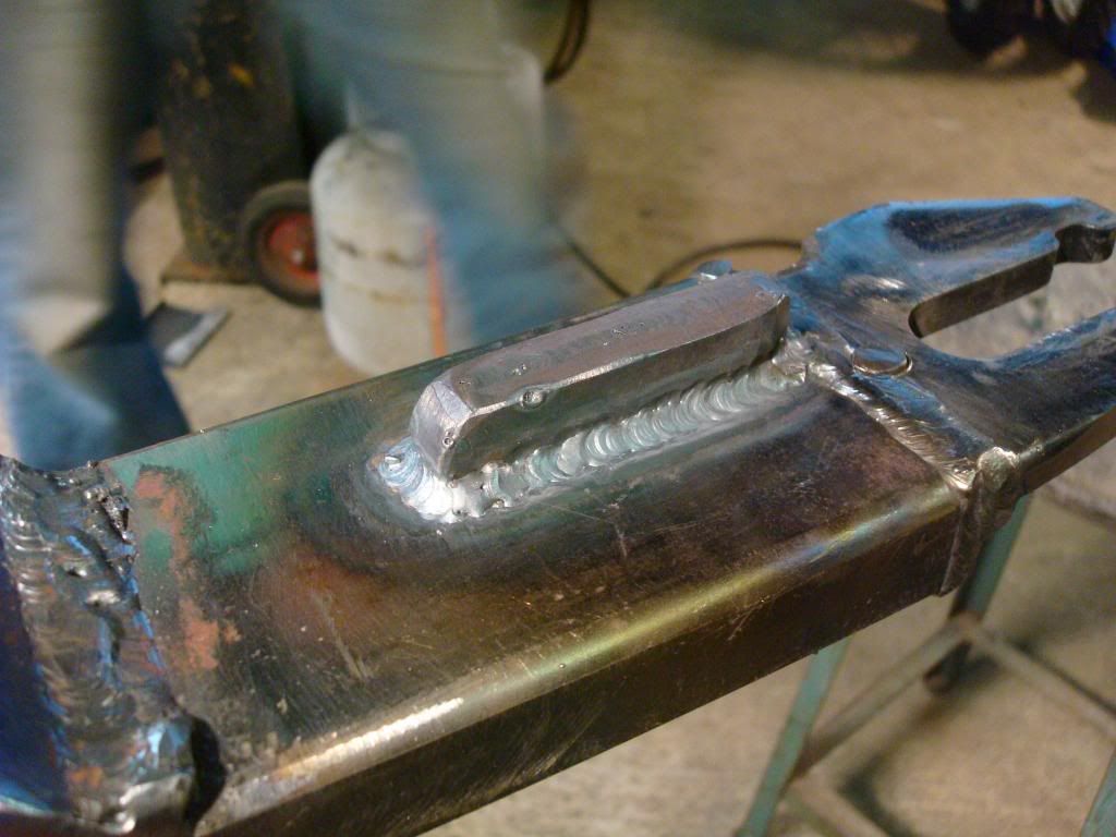

After fitting up the axle and brake stay, it was time to make some provisions to attach chain sliders, aka: "gussets." Which was followed by more welding.
With the gussets welded in place, some UHMW (ultra high molecular weight) polyethylene was carved up for the chain sliders:
