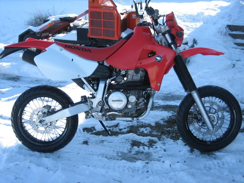

I have been plugging away the last couple of weeks on my dual sport conversion. It's starting to come along.
I've been kinda stumped by the fender half way to the axle requirement. Call me picky or whatever but, some of the fender extensions look kinda crappy I think. But then it's a dirt bike so who cares?
Anyway I hacked up the old front fender and made a hugger. I'm thinking about painting it mat black so it doesn't stand out so bad. Do you guy's think my fender will pass inspection?
Sorry, I would not pass your fender. IMO it does not do whats intended.(Keeping rocks out of cars windshields)
What we have been doing is making a fender extension out of rubber, It hangs down a bit behind the license plate and is easy to deal with. It looks fairly decent as well. Easy to do and cheap.
