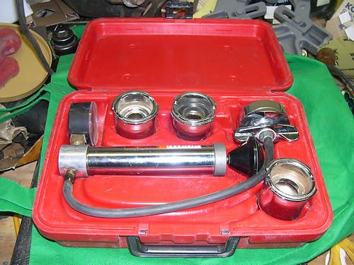

checking ph
Snap-on cooling system pressure tester to make sure everything is holding tight
