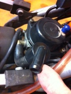

Originally Posted by philosobrad View Post
Just awesome. I picked up an '01 Monday night in Kansas City, the PO had decided to part it out, so I'm in the process of putting it back together. I'm 90% there, but does anyone know where this hooks up:
It hooks to the EPC assembly found on Euro bikes, that appearantly neutered the power in 2nd & 3rd gears, I believe! US models its open to atmospheric air, but tends to suck alot of dust into the upper portion of the diaphragm. Either in the BST40Bible or one of MotoLabs thread there is a K&N part number for a filter to help it out!
