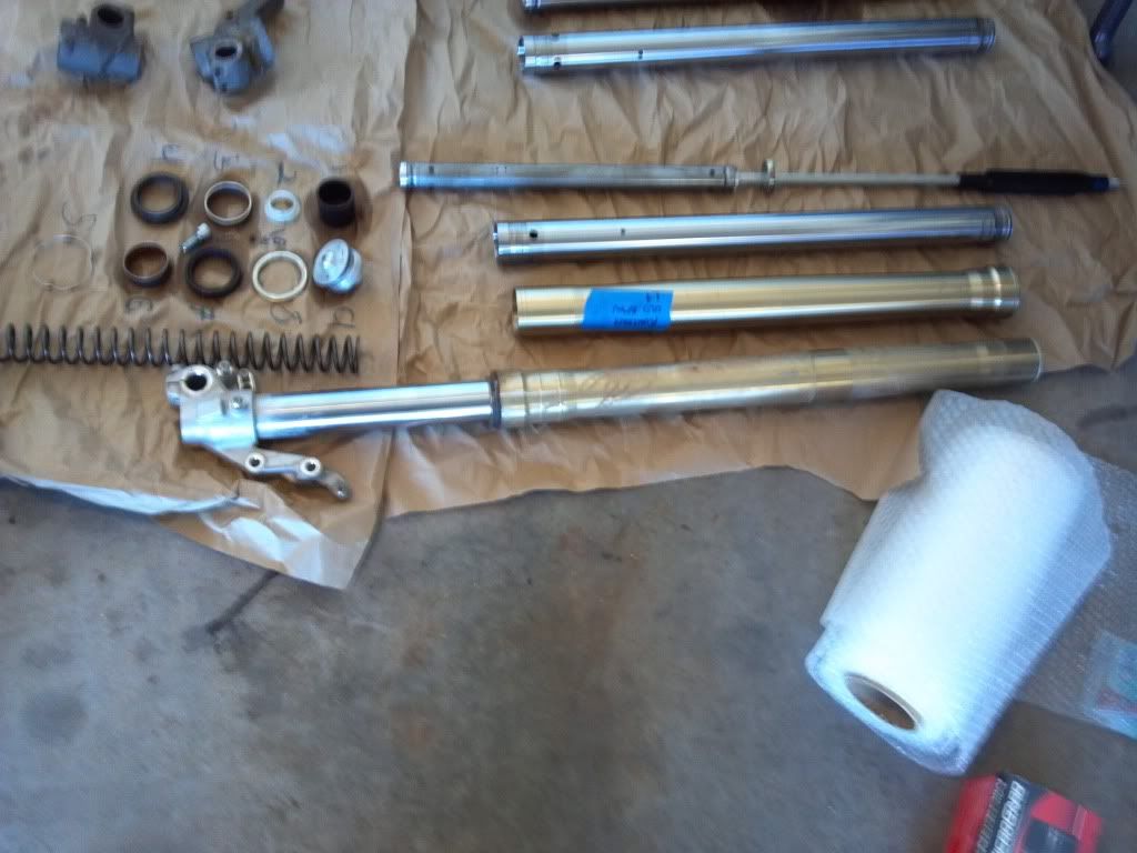

Originally Posted by Casejeep View Post
Took the morning to take my forks off.
if anyone wants to know where the xChallenge gets the extra 40mm of travel take a look at the uppers(gold tube) from both forks and you have your answer, it is ~40mm shorter then the F800GS allowing the fork stroke to be longer giving it the extra travel.
