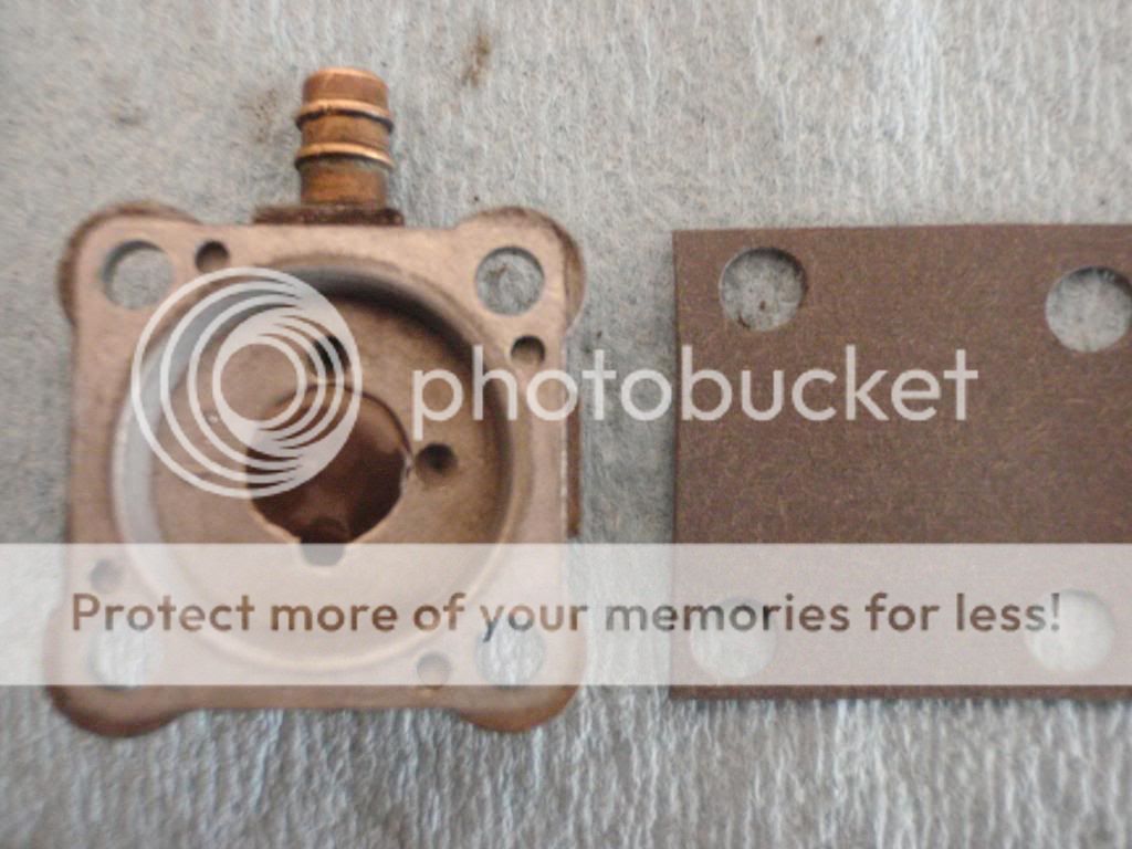

Yep, the seal was leaking pretty bad!!

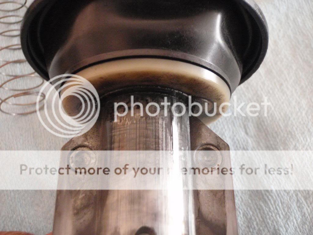

Hurricane mod, no more vacuum trouble!! Oh boy, how am I going to be able to remind myself to turn the petcock off????
After taking off the carburetor it became pretty obvious that at some point or another I had indeed oil coming into it

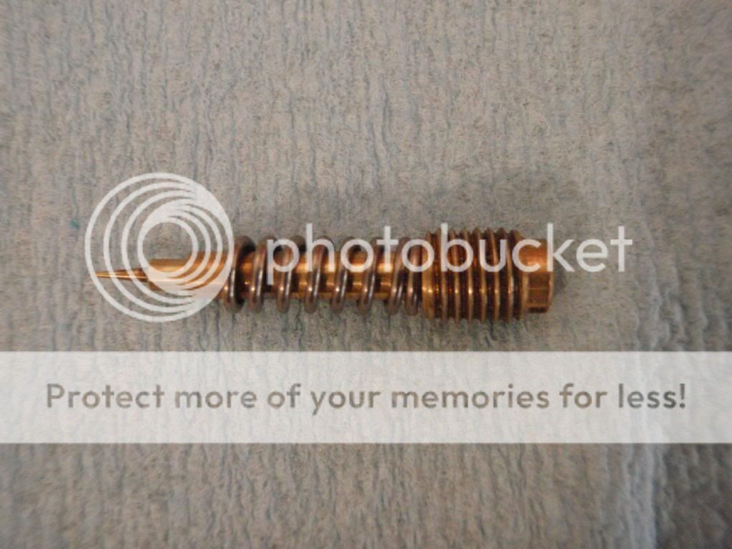

Turns out my pilot screw didn't have an o-ring, I did find the teensy washer, which I ended up using for my 22cent mod (raising the needle a teensy bit for more fuel, my spark plug was white)

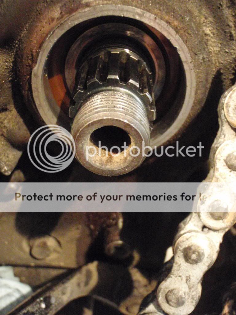

Once I had the cover off to check my balancer chain and cam chain I discovered that my cam chain was really lose! I could move it an inch sideways, what the heck??
Turns out the my cam chain guide was stuck, so the tensioner was not able to push in the chain to tighten it!
That's fixed now.
I also repositioned the balancer chain. Spirit vibrated horribly, and I'm not sure what happened, but the chain was not where it was supposed to be, (lined up with the dots) I must have had a brain fart when I aligned them last.
