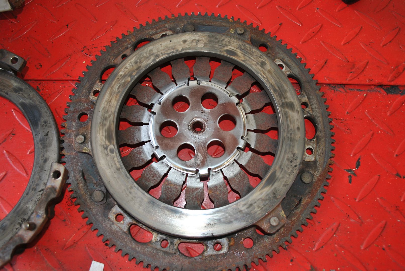

Took a couple hours to break the bike in half. It had a leak that needed to be fixed. At this point we didn't know what was leaking.
The back half looking forlorn.
The leak is the balancer shaft seal. Simple fix once the part comes in.
However, the clutch is obviously burned. You can feel the unevenness from heat. The disk is in spec, but I am recommending all parts be replaced.
Fortunately no other issues. The trans input shaft was in good shape, but very dry!
Once parts are in I will be putting it all back together.
