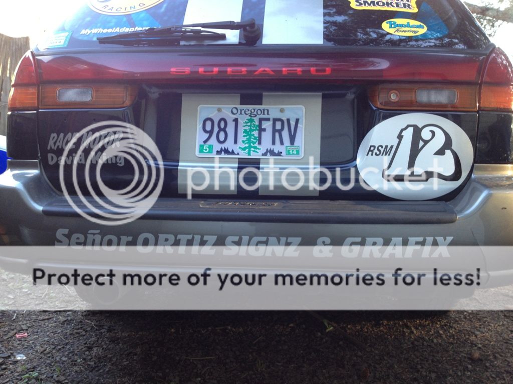

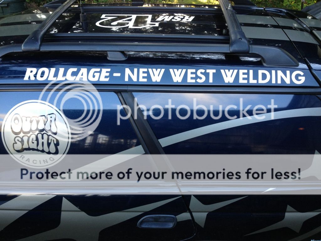

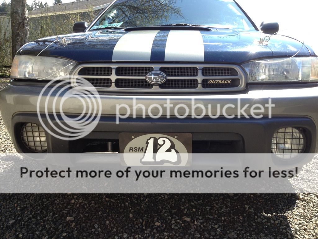

I left Ray's and headed over to Lonnie's. He was willing and able to finish up the graphics. So I washed the car and he got to work. He wanted to do some simple stuff but also let people know what the sponsors did ... actually it was just Ray, Tim and Lonnie that were not on the car yet (My buddy from the Interstate All Battery Center in Hillsboro and Beaverton was still trying to get me some stickers).

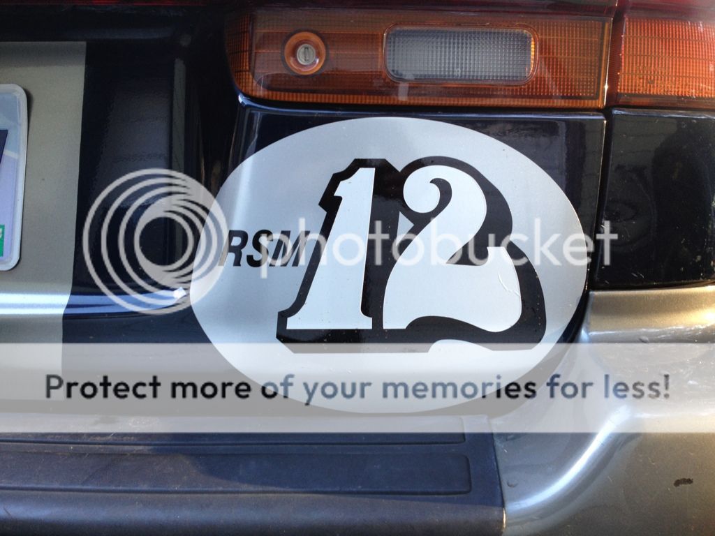

By NORRA rules we needed 4 inch numbers in front and 6 inch numbers in back. I wanted to incorporate the feel of our SL350 race bike that brought us to the finish line for the past two years, so Lonnie made up decals that are replicas of the bike's front number plate
Front:
Back:
Love for Ray:
Love for Tim:

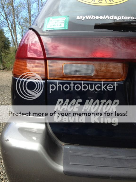

More love for David:
I texted David that photo and he texted back that if the motor blows up during the race, quickly remove that sticker. I told him they were magnetic decals because I was already thinking ahead
And love for Lonnie, who decided to change his business name to a more appropriate one in honor of the M1K

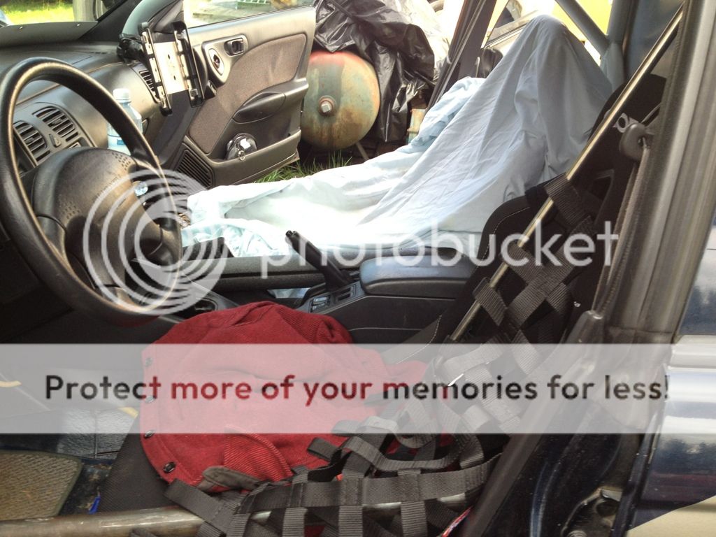

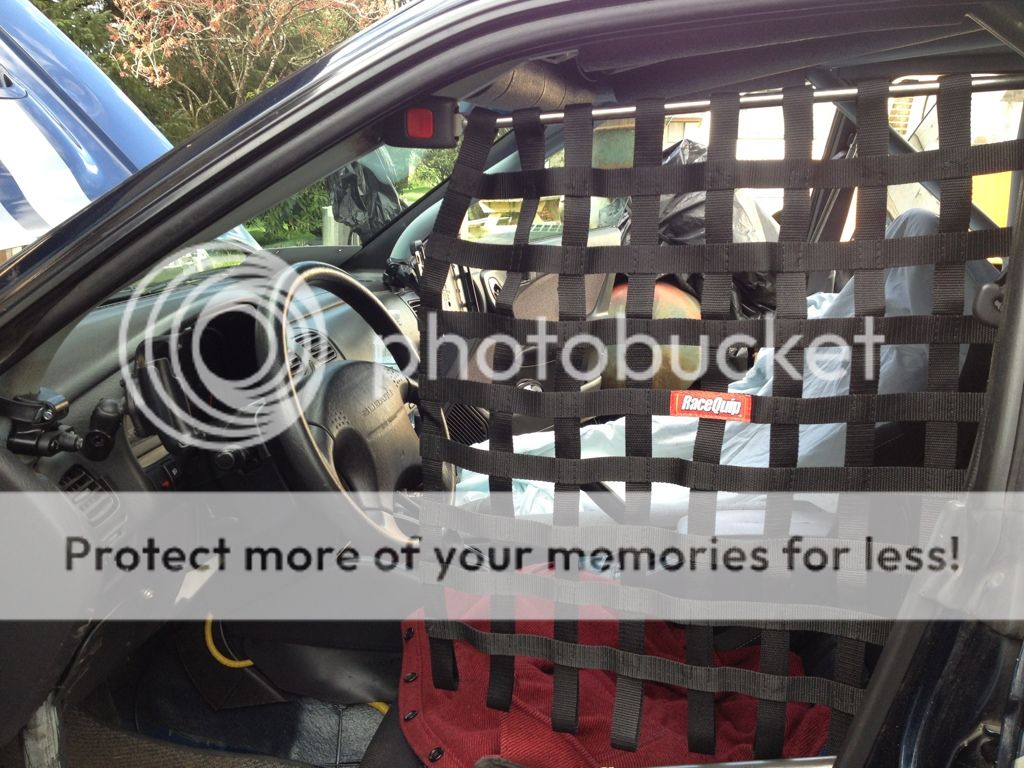

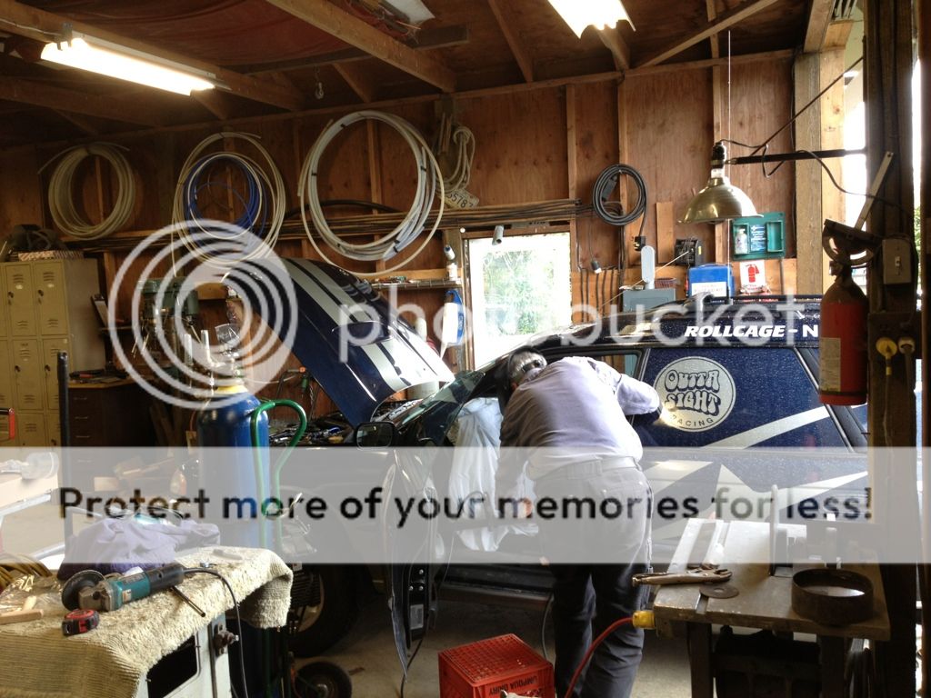

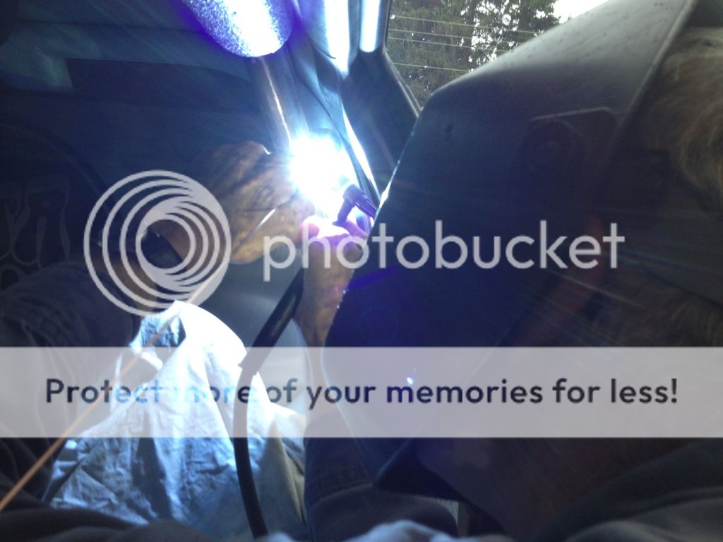

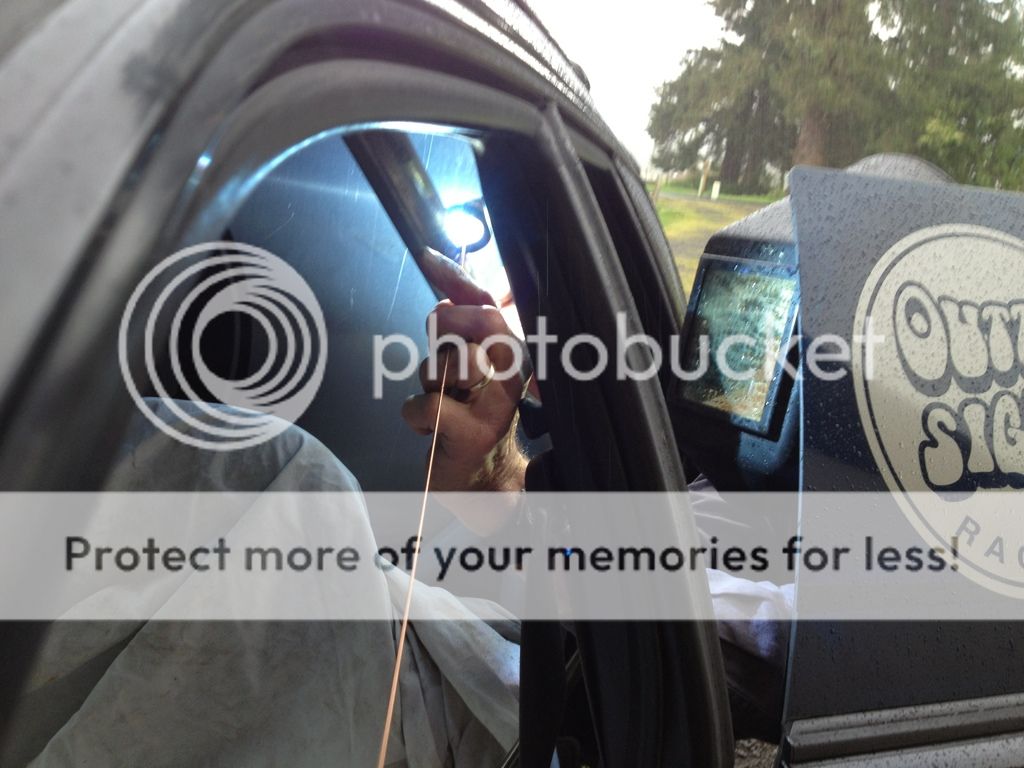

Ray called and said he was ready to do the window net install.....so after Lonnie's, it was back to Ray's shop!

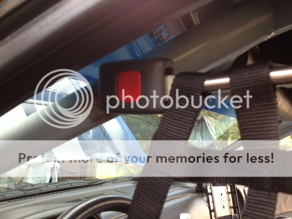

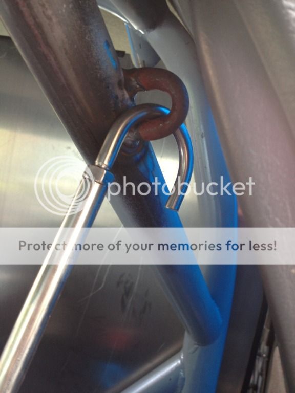

Ray came up with a system that I believe rivals, if not outshines the commercially available window net kits I have seen. I think we may end up making up more for sale at some point! Ray was able to use the rear seat belt components out of the Subaru, which I was hoping we could do.
The system will allow for easy removal by the occupants and by bystanders who may respond to help us out of the car in the case of an emergency. It's hard not to see the bright orange "Press" button and instinctually know what to do. The top bar is a quick release type which will then swing down and store out of the way when not being used. The bottom bar will be strapped to the door bar of the cage. It works so slick and it is stronger than it is required to be. Believe me, I know how lucky I am to have guys like David, Ray, Lonnie and Tim on the Outta Sight Payroll*
