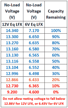

16 cell = 9.2 amp hour actual, 20 cell = 11.5AH actual
new style A123 are 2.5AH per cell, old style 2.3AH.
with heated gear actual amp hour comes into play in terms of reserves remaining to start next morning. especially in cold conditions.
LiFePO4 reaches full charge at 14.6V ... operating range is 13.3v to 12.85v (20%)
think water flowing in a pipe ... voltage = pressure amp/current = flow
LiFePO4 battery will charge at 13.8v, but rate of charge will be slow. at 14.2v current will be pushed into battery faster, resulting in a fully charged battery quicker.
to check what state your battery is being charged to:
after your normal ride, put bike away .. next morning before starting bike, measure resting voltage. (assuming no excess parasitic drain) note it's important to use a known to be correct meter. cheap $15 meters are fine, if it's been checked against a known meter like a Fluke.
chart below will show state of charge for your LiFePO4 battery.
if your battery shows say 13.6V after resting overnight. it's fully charged, it's probably OK.

I'm a little confused. You say operating range is 13.3v to 12.85v but it will charge slightly at 13.8v. When mine gets below 13.5v the little meter on my bike has pretty well gone solid red which I thought was pretty close to the end of the world. Was 12.85v a typo?
At what voltage does the battery start being discharged?
I checked the voltage of my battery yesterday after the bike had sat for 5 days after a 4 hour ride. Voltage was 13.6v.
Checked it again today after running it about 30 minutes yesterday and it was 13.7v
Did some tests yesterday and today and with everything off that can be turned off, the voltage climbed to 14.3v and stayed there. With everything turned on including both the jacket and grips on high, the voltage dropped down to 13.5v - 13.7v @ 4000 rpm. I didn't leave it there for a long time but the voltage seemed to be deteriorating.
So, does it make sense that the system seems to be struggling to power 290 watts worth of bike and gear?
By the way, my meter is a cheapy $50 meter. I've never checked it against a good meter but, I'm sure I have to go into town tomorrow and maybe I'll see if I can find someone to calibrate it for me.
