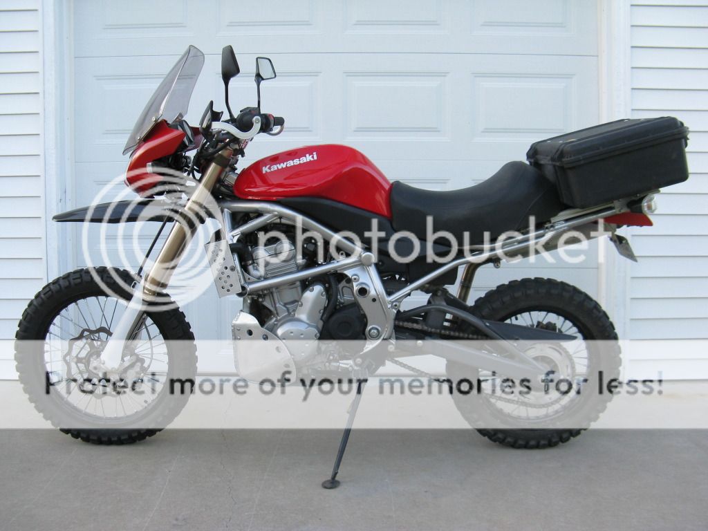

These criteria led to rack design that I built for the Ninja. This rack design was going be tested immediately as I had a Colorado back country ride planned. The key design trait was the rack main body, a 3/16” 6061 aluminum plate (light weight) with 2 horizontal grooves cut into it. These grooves would allow 4 plastic pucks bolted directly to the Pelican case (adaptable) to slide into the aluminum plate from the rear (quick connect). The Pelican case was hooked to the plate by a rubber strap that acts as a shock cord. If the box took an impact from the front, it would slide backwards in the grooves and the rubber strap acts like a shock absorber (forgiving).
The rack system looks like no other rack on the market and has kind of a high-tech billet look to it (looks good). The rack system worked great on the Colorado ride and I thought other advriders could use the features of this system. Unfortunately there is no market for Ninja dual-sport accessories.

Slider top box prototype on Ninja 650
