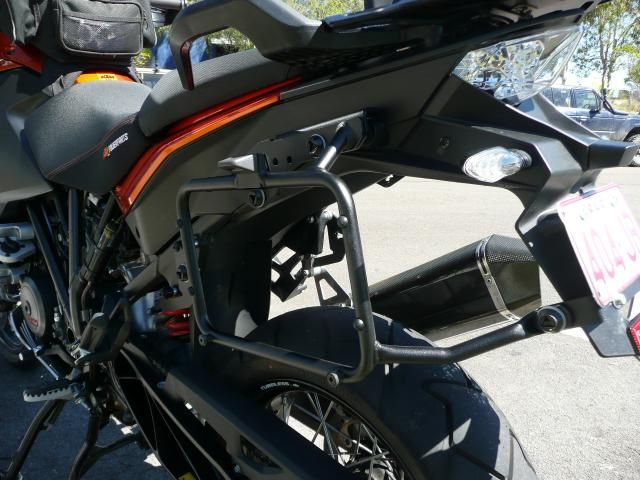

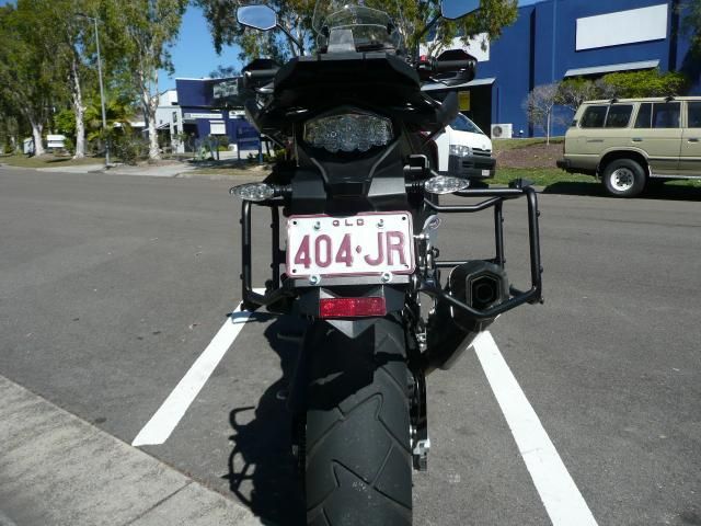

The GIVI quick detach pannier frames are a thing of close fitting beauty... on the left hand side...
...but not on the right hand side, yikes! My plan is to reposition the Remus pipe to fit under the RH pannier then cut the arms off the main rectangle pannier frame, shorten then re-weld and re-powder coat. I intend to use GIVI 33L Trekker boxes because they are not too heavy unlike some pannier boxes, quite narrow at 21.5cm and best of all not very expensive yet well made. The total pannier width with these boxes will be 83cm. By comparison the relatively narrow Yamaha XTZ1200 panniers are 89cm wide while the R1200GS Adventure's heavy alloy boxes are over a metre wide! Good for some but I hate having too much "wind-age" ...no good for tyre wear, fuel consumption and squeezing between the trees!
