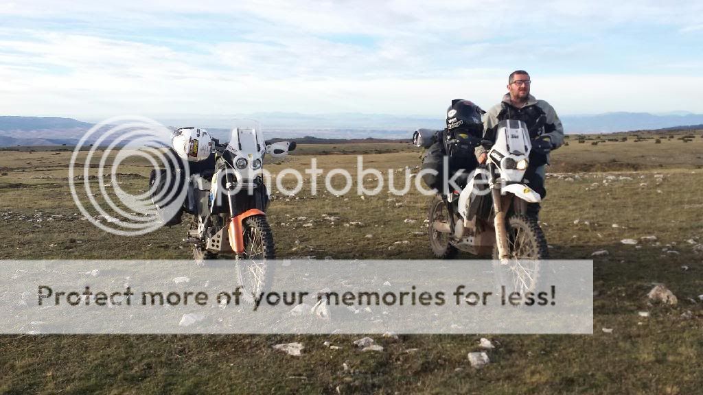

I've just upgraded my bulbs and ballast. I now have 50w 6000k HID dip beam, and again I previously had the original 35w Halogen main beam, but now have the same 50w 6000k HID main beam with 'Ultra Fast' ballast fitted(HID Main comes on instantly and no 30 second delay)
100 watts HID
Couple of pics below of the Lynx fitted to my 690 and my mates G650 X-Challenge up on the Spanish Pyrenees a couple of weeks ago
