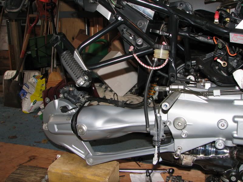

I replaced the rear paralever pivot bearings that were overdue for replacement. The front were still good. I cheated and used blue locktight for the stationary pivot , and nothing on the adjustment side to facilitate adjustment later if needed. The small dot of paint on the pivot and adjustment bolts give me a visual confirmation that nothing is loose.
