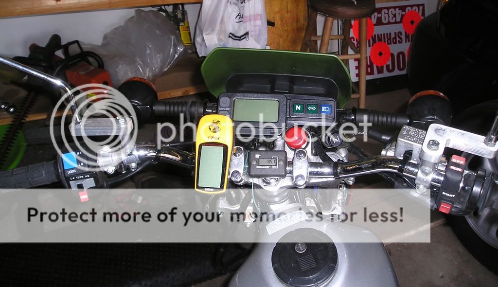

Heres my 01 sherpa. Not many miles, but it sure is a fun ride. Ive got a trip planned for mid sept in the Black Hills.
Ive got some extensions for both mirrors, so its much easier to see behind me now. I wasnt used to having to shift my body, so I could see over my shoulders.
The red cap over the key socket, is to remind me, that theres a padlock in the rear disk...Its a good reminder for preventing those senior moments.
The center black box is the hour meter/tachometer. Really handy for keeping an eye on what revs its pulling.

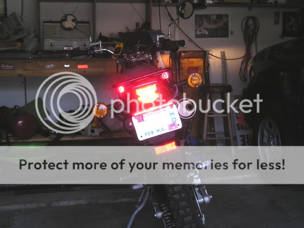

Ive added some very bright red LEDs to the rack, and a strip LED light above the licence plate. Its pretty intense at night.
