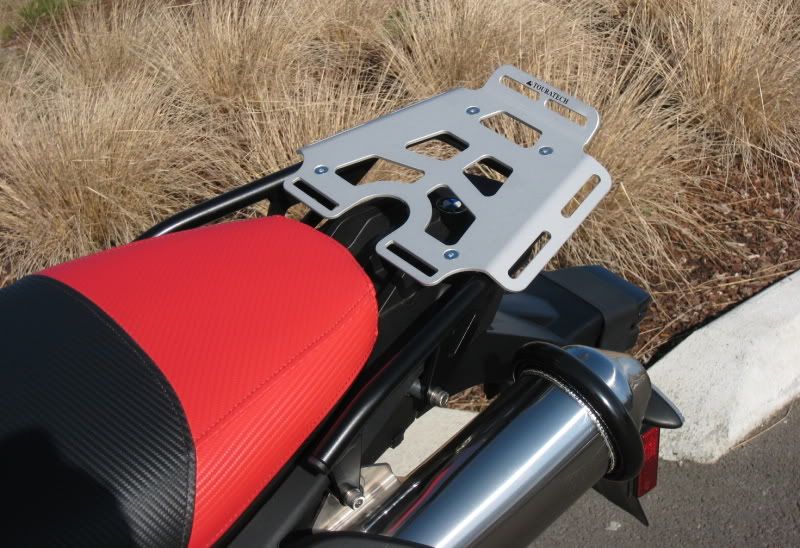

Luggage Rack from Touratech
I don’t really like this rack. And it’s overpriced. I’m waiting for something better to come out. (Edit 6 months later: Never did find a better tail rack so I made my own. See post #37 on page 3 of this thread.)
