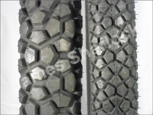

The Original fitment tyres for your bike are still available. They were designed for your machine wear well and are very cheap for a pair. You'll also never find better tyres for handling on and off road Metzler Enduros 1 & 2
