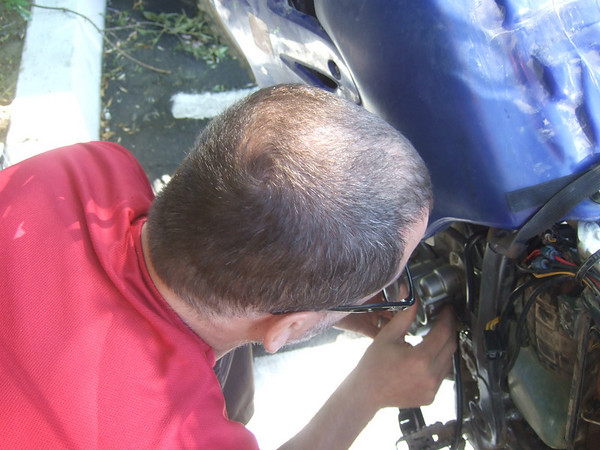

What else did I find?

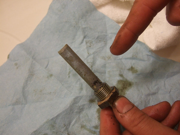

Well, Steve & Roy discovered a potential liability in the DRZ design, which is the internal oil screen that sits between the frame reservoir, and the sump. It requires a 24mm deep socket, which I purchased from the AutoZone.
The screen was clean .

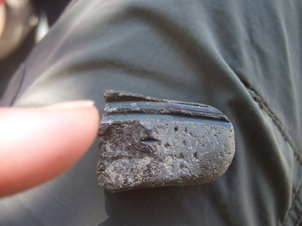

Next, I discovered a stone that had wedged below the chain in the lower chain-guide. It had been scored by the chain:
otherwise, didn't seem to be doing any harm, although the chain didn't have quite as much slack.
I salvaged the case guard from the stator-side cover,
Then it was time for an oil change for HoneyBee.

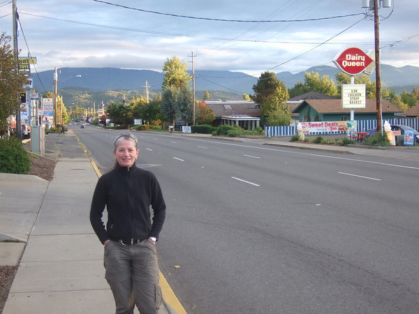

Grants Pass is really spread out.
Everything is arranged along a strip... there's a small downtown, but it's really quite far to walk. Like many towns, the design optimizes transportation by automobile. What will it take to shake this obsession / addiction? I mean, wheelchairs also are available so you don't have to walk... but nobody's fetishizing those.

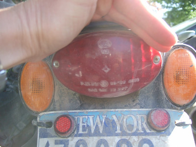

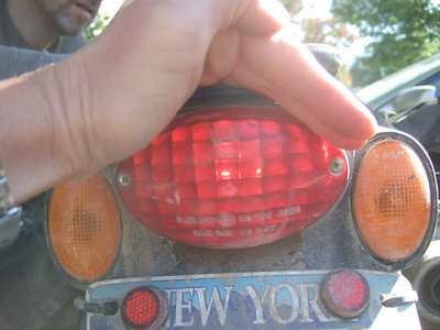

Hey, left-rear turn signal is busted.

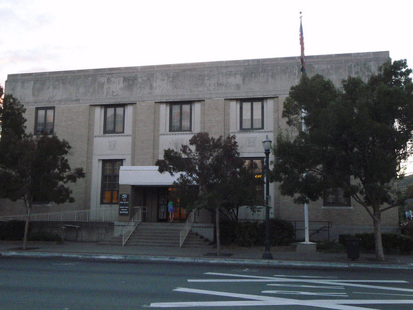

Grants Pass
A colorful lady:
And another:
She was going to the P.O.
Sky scraper:
I have a collection of faded signage on brick walls:
Dinner was at a local brew-pub. I'd rather have been riding / camping... No offense to Grants Pass intended.

>"Everything is arranged along a strip... there's a small downtown, but it's really quite far to walk. Like many towns, the design optimizes transportation by automobile."
No design or planning was involved. Like so many other towns, GP just grew along a highway. A flat spot + intersecting highways + river = town. 40-odd years ago there wasn't much to GP. The little downtown section between the 'It's the climate' signs was the whole marianne. Now in the summertime they often have gridlock through the downtown section. Too late to do anything about it.

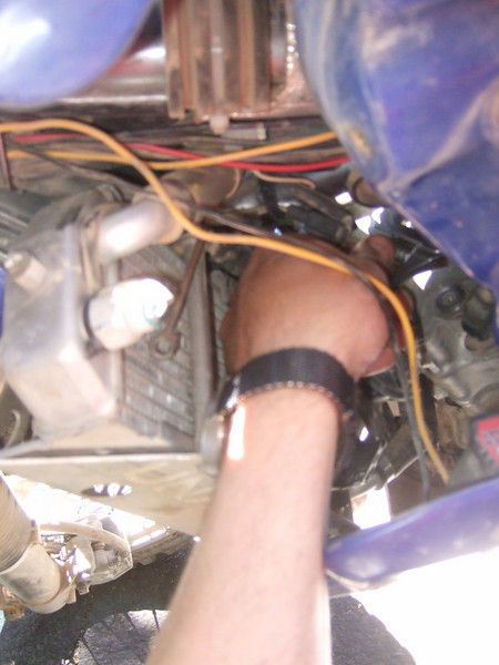

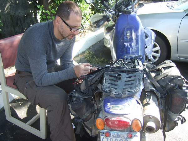

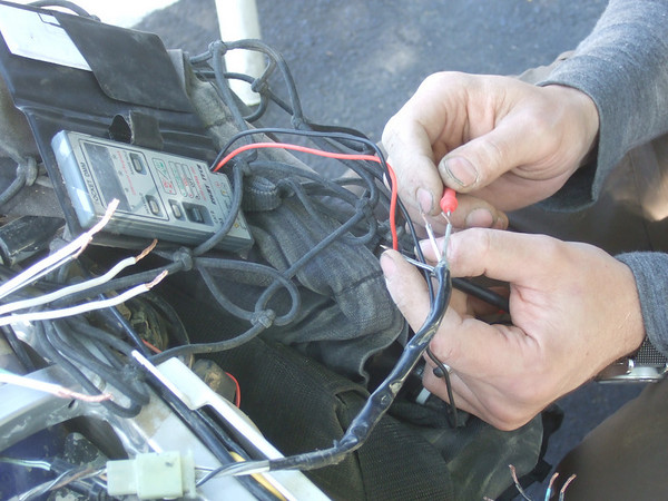

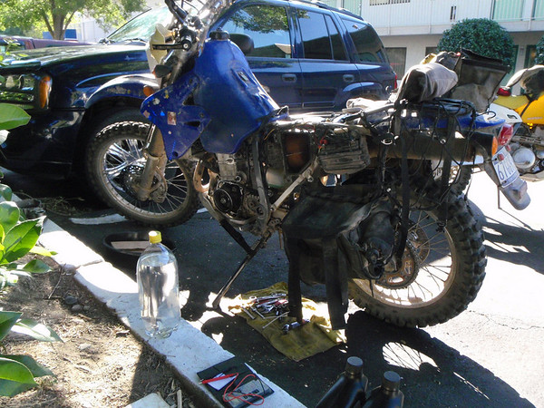

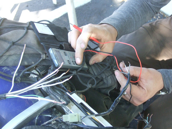

Today's big project was to rewire Blueberry's tail assembly. But first, I recharged both batteries by taking laps up and down the strip. I didn't want to ride too far from the motel, in case I stalled the bike before the battery was charged.
riding stats for the day... 18.7 miles!
There were seven wires, and because I was going to re-route the harness so it wouldn't happen again, I needed more slack, which meant 14 splices.
I bought a spool of wire from the AutoZone, I would have used the cable I'd salvaged in CA, but on closer inspection, the insulation was old and cracking.
Testing... 1,2,3...
Yeah, baby!

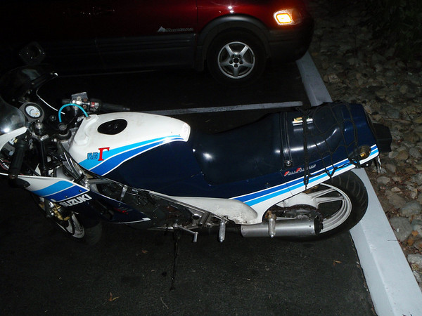

who was staying at the motel stopped by to chat. Joe was riding a 2-stroke Suzuki R6 Gamma sport bike, obviously not available stateside. He offered assistance and encouragement.
All our maintenance and repairs (except for the big one) completed, we whiled away the hours poolside,
Where we ate lunch and discussed how we might catch back up with our route in the event that we could get Blueberry running again.
When evening came, our dining choices were limited 'cause it was sunday, so we settled on the Sizzler across the street.
On the way back to our room, I saw our friend Joe's bike parked...
I hoped he'd have a use for a 24mm deep socket that I didn't want to be schlepping... just so he'd know who it was from, we left a calling card:

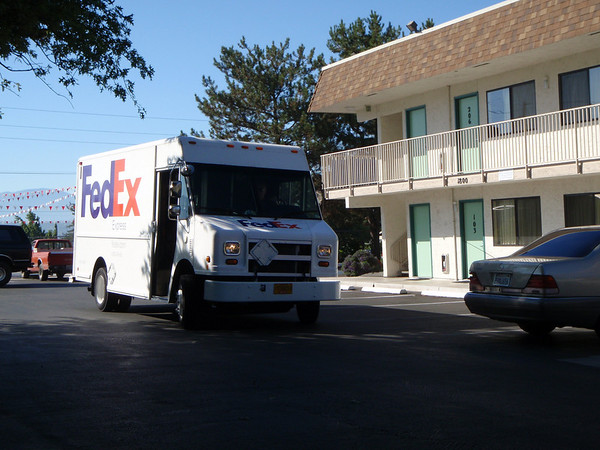

Waiting for FedEx... I had Honeybee packed, Blueberry disassembled, tools out...
Checking the FedEx web page for tracking updates every 10 minutes...
Pacing back and forth in the parking lot... Popping into the motel office for free coffee refills...
My stomach was in knots.
Old 10-13-2009, 07:54 AM   #2291
DR. Rock OP
Part of the problem
DR. Rock's Avatar
Location: NYfC, yff
Oddometer: 5,342

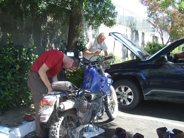

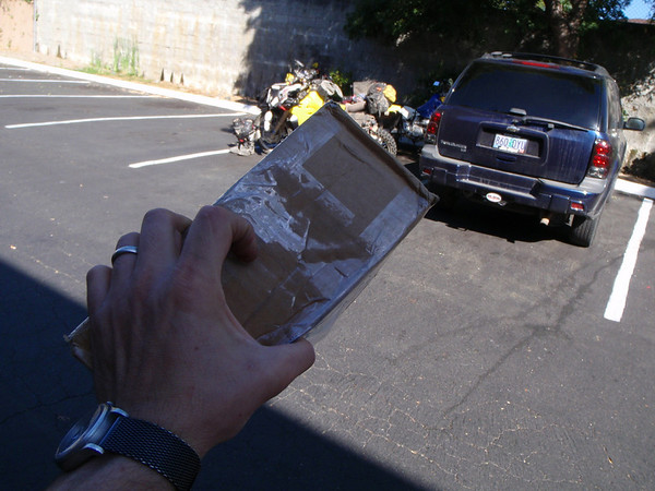

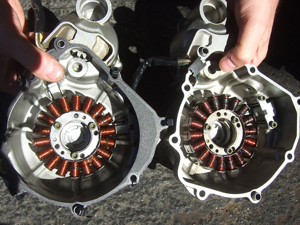

As soon as I saw this guy
I went into my focus zone... It's showtime!
I handed LDF the camera, and got to work.

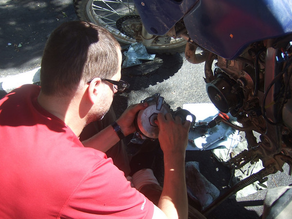

It was already 10:45, and at this point, even if everything went perfectly, it was going to be a crapshoot making it to Port O by nightfall.

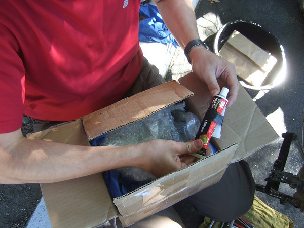

Steve thought of everything... RTV gasket, disposable gloves... whatta guy!
New (used) and old (dead):
Old 10-13-2009, 08:12 AM   #2292
DR. Rock OP
Part of the problem
DR. Rock's Avatar
Location: NYfC, yff
Oddometer: 5,342

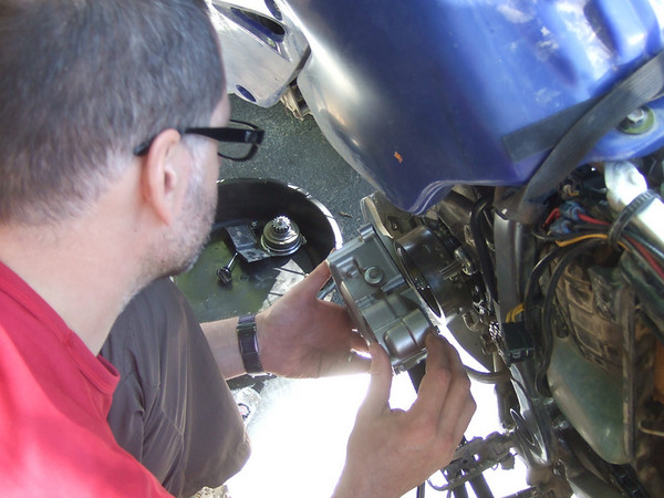

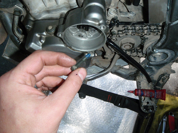

Commence re-assembly
it didn't go without a hitch... there was a shim/washer and bushing missing from the case Steve sent me, so I decided to use that case and stator, with all the other bits from Blueberry's original, but I was struggling to get the starter clutch gears to mesh and the case to seat properly.
At one point, one of the washer / shims dropped, and for the life of me, I couldn't find it. It was like it evaporated. I hadn't heard it hit the ground, so I spent 5 minutes looking in all the rags, and my pant cuffs, and all over the parking lot, until eventually, laying my head on the ground, I looked up and found that it had been sucked into the rotor and was stuck to the magnet on the inside, underneath.
The starter clutch gears meshed easily once I swapped the original for the one that came with the new case... I don't know if they are matched to the case, or if it was just co-incidence.
Locktite all around:
Then I waited 90 seconds for the RTV to cure... That's plenty, isn't it?
Poured the oil in, reconnected the battery and all the plugs, and...
Now what???

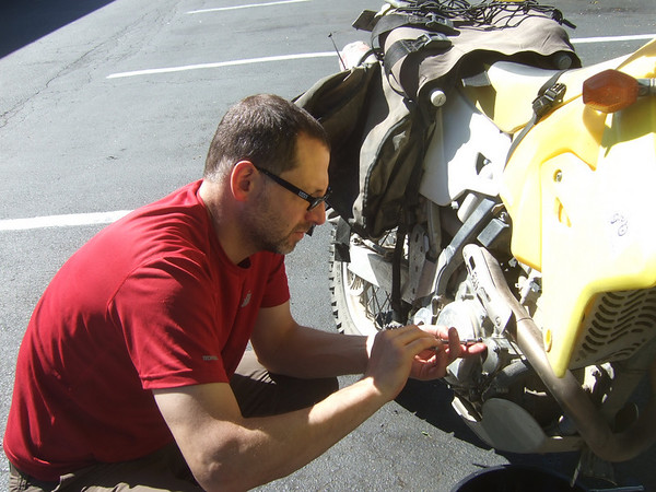

Ok
Back into troubleshooting, diagnostic mode.
Fuel? check... petcock on. Air? check... Spark? hmmmm...
Well, if I was going to pull the plug to check for a spark, I may as well take the opportunity to change it. So I unscrew the shrouds, and loosen the gas tank to get exposure to the spark plug...
and the fuel line cracks and gas starts to spill out of the petcock.
I realize it would be quicker to have LDF pop over to the autozone and buy a new piece rather than dig through my bike to find the spare piece I had packed. While she was doing that, I changed the plug,
and sure enough, there was a strong spark. By the time she returned, I had the bike buttoned back up, and was ready to try again:
