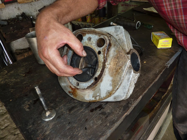

So we're at a stop behind a line of trucks after climbing 25km or so. The bikes are side by side and idling when mine "clacks" and starts making a rackety tapping. We all look at each other wondering "what the hell"? I attempt to get it to the side of the road and it coughs dead. One stroke of the kick starter told the story: no compression in the cylinder any more. We hemmed and hawed about what to do for a bit then I popped off the gas tank and started to take a look under the valve covers while Minxter started helping herself to a little left over McDowells whiskey from the night before.
I found one of the problems right away. The exhaust valve push rod was no longer pushing on the rocker arm, it was out of place.
Here my finger is pointing at the dislodged pushrod which is no longer pushing against the rocker arm. I thought, "cool, I'll just get it back into place and maybe we'll be in business, at least to get us to a shop". Good theory but when I got it back in place there was about 1/4" too much clearance. It was like the valve wasn't shutting all the way.
I also found other things I didn't really like in there. When I removed the rocker arm I found metal shavings that had been pumped up with the oil and were jammed in the ports. I also found some sort of cobbled shims that a previous mechanic had inserted between the rocker arm covers. I suspect they also had seen these metal shavings and were trying to compensate by shimming open the covers so the oil would continue to flow. That's just a guess, but I know for sure these shims were not stock. They were cut from a can or something.

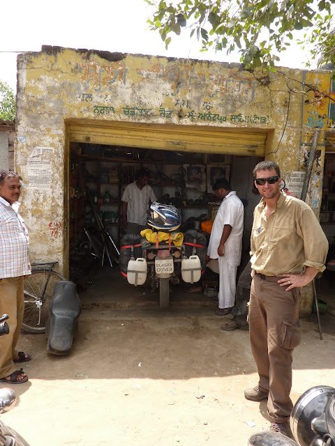

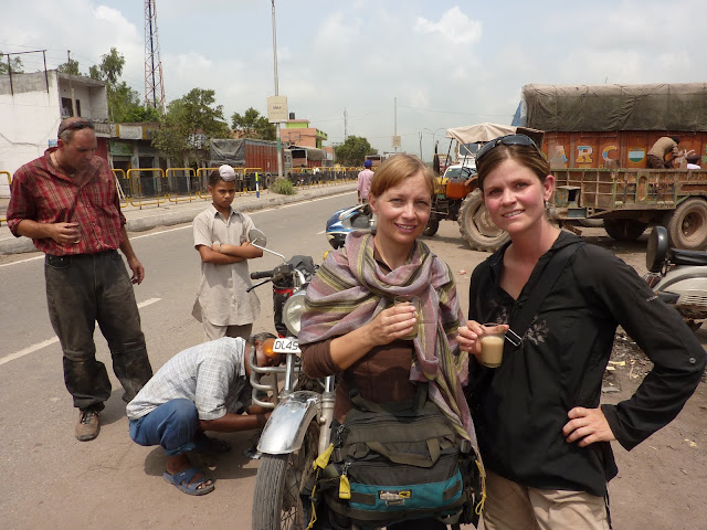

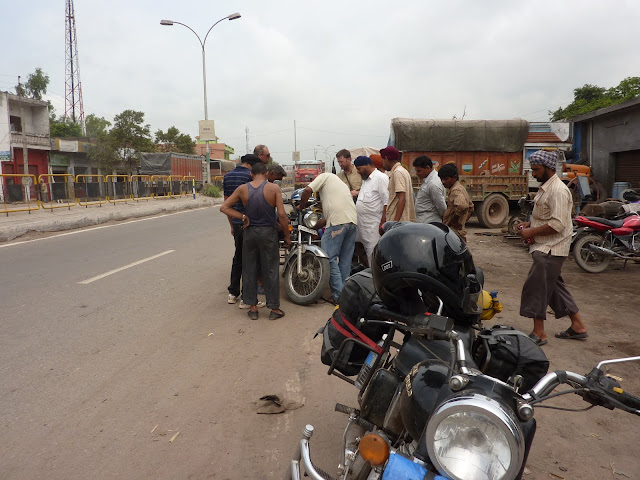

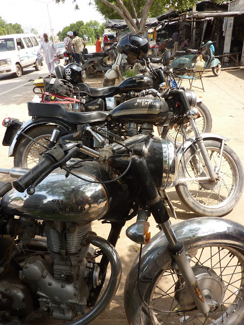

day 3
The day started by packing the bikes up, having a quick bite at the Himachal Hills Hotel (800 rps no A.C. for the room that night)and off we went with one bike dead. We decided we would coast back down the hill towards Kiratpur and see if we could find a mechanic who could help us out with the stuck exhaust valve. Once the road leveled off we would bring out the tow strap and pull it the rest of the way into town.
From India/Kashmir Trip
This technique worked pretty well and it didn't take long to get back down to Kiratpur. This town is basically like a huge truck stop where TATA drivers prepare or repair their rigs for the steep climb into the mountains. The road is mostly dirt and the dust is extremely thick. That combined with the heat and humidity made it just miserable conditions for just looking for someone to wrench on the bike.

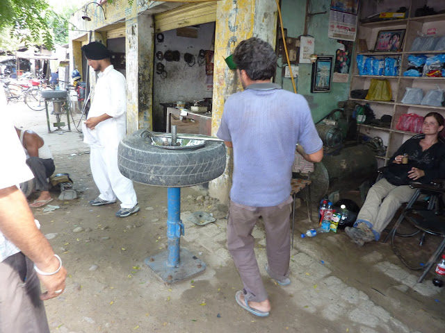

With Joe and Minxter in tow we pulled in front of each shop that looked like they had the tools and knowledge to help us out. The first couple of shops didn't really even want to look at the bike and shewed us off with one of them saying we needed a "Big Hospital" for the bike. The traffic was thick and I was getting worked up because of the heat and dust. Then I spotted a shop with a bunch of scooters out front being worked on. I figured we would check it out. Well, I guess the bags strapped to my bike was a little wider than I thought and I clipped this guys Lambretta scooter with the bag and sent it crashing down in the dirt. Every head swung our way as the guy who owned the bike picked it up and sifted through the dirt for all his carburetor parts. They were not impressed and definitely not going to help out with the bike. So off we went.
The next shop we stopped at was totally different. Everybody wanted to help at this shop. This was our first experience with the Indian people who don't know anything about bikes wanting to tear right into the motor and fix the problem. Usually adding to the problem significantly. At this point we were still being polite to anyone willing to lend a hand. That would not last long.
From 2010-09 India Enfield Trip
This guy would not believe the valve was stuck and just wanted to braze a spacer on the rocker arm. These guys are the kings of improv and the cobb job. It was so chaotic and they just would not listen to anything we said. Joe finally accepted what was going on. You know a little Chai tea will sooth the situation. Really works.
An older Sikh man offered to take me and find a mechanic. I would load up on his scooter and he would hook us up. What the hell?
He basically stopped at all the shops we had already spoken to and really didn't turn up much new information. Luckily he did not stop at the shop I pissed off by throwing all their parts in the dirt. Even though he didn't turn up much info I felt fortunate to have spent some time with this guy. He didn't really speak much English we communicated all right. A key cast member in what was shaping up to be the second of many difficult days maintaining this sweet piece of english engineering manufactured in India.
When I returned there was a younger man who showed up and explained there was a R.E. mechanic about 20km up the road in Anundpur across from the Sikh temple. He was actually one of the few Indian guys still riding R.E. and said this is the mechanic to go to with our problem. We put the bike back together and were quite surprised it fired up with no compression and a stuck valve.

We arrive without incident into Anandpur Sahib which is a very special place to be. Known as "the holy City of Bliss," it is a holy city of the Sikhs and is one of their most important sacred places, closely linked with their religious traditions and history. The motorcycle shop is located directly across the street from the temple in the center of town and is owned by quiet little bearded Sikh man named Nattu.
From Drop Box

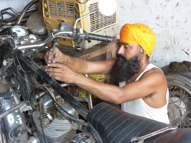

We pulled into his shop which was little most shops in India, a concrete strip of shops all about 100 square foot space in a line of around 10 or so shops side by side.
Nattu had plenty of business the day we rolled into town, which I think is a indication of the reliability of the Enfield. If you are going to be a mechanic in India. It would be a wise financial decision to choose to specialise in the Enfield.

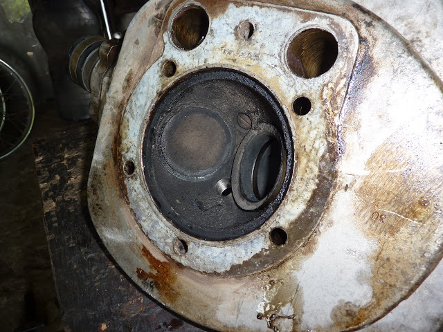

Once Nattu pulled the exhaust valve cover off he knew instantly what the problem was and told us to take a seat and a cup of Chai. He could fix it.
You can see here the Valve seat has slid out of the head and is not allowing the exhaust valve to close all the way. This is the reason for the lack of compression and the slop with the push rod and rocker arm.
Nattu made a couple of phone calls and told Joe he needed to take the head and a young man as a translater back down the road to Kiratpur to have the valve seat pulled out. The machinist would then turn a new valve seat from scratch and press it back into the head.
This work took about took all most of the day and ended up costing us just 300 Rps for the machine work on the valve seat and head.

Here's a little more on Day 3. The first shop we came across, I showed they guys the problem with the valve. They had a look on their faces that was not good and one guy says in broken english "this bike needs big hospital"!
Indian taxi?
I don't know if Buurrt got across just how intense the situation at Kiratpur was. It was dirty as all get out with dust flying everywhere, trucks rolling in and out and people scurrying all over. We had a major language barrier there making it hard to discuss what was going on with the bike. Here is a very typical scene in India. Westerners will start to draw a crowd. Indians will slowly start to appear and watch. Many of them are friendly and will try to help EVEN IF THEY DON'T KNOW WHAT THEY'RE DOING! But they are trying to give you assistance. It's great and I really like that they just want to help you. Others that aren't helping will just watch. And watch. And watch. Even if you're not broken down, maybe you're just pulled over to rest and have some water, Indians will start to appear and watch.
More dudes are coming out of the woodwork offering their opinions. We get Smart Motors on the phone with the main mechanic and Myheap at Smart Motors tells the guy to adjust the push rod and send us on our way. I know there's something way worse with the head then just a push rod out of adjustment.
In the meantime, we've adjusted the push rod as best we can and these guys are suggesting we try starting the bike. I'm thinking, "no way, there's something not good in the head". But we kick the thing and it fires up!! I can't believe it. It's definitely not running right but these guys say just go easy and it'll make it to the next shop. We got a tow rope so we're not concerned if it breaks down so we take off. It's mid day now.
