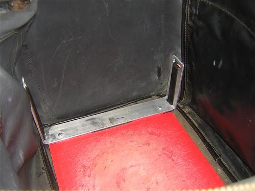

Time to finish my racks. I got some Wolfman pannier bags last year and have been trying to make time to make some racks to suit. I used some 8mm bar for the outer frame and and 6mm bar for the 2 vertical risers. Some 25 x 3 and 25 x 4 flat for the attachments and should be OK.
I printed out a picture of the Wolfman frames off the web and scaled the dimensions from it. I didn't buy the genuine item because I wanted them a bit lower and further forward, and gotta justify the MIG. Cost about $10 + a day in the shed. I also changed the strap that goes over the seat so I don't have to sit on the buckle.
Will test this weekend as am off to the Wallerwang and the Hunter Valley.

Ready for loading.
The tank pannier bags I got at the same time from Procycle too. After some playing about with webbing they work well, and have done a couple of trips to date, including 900 kms to Dargo and back via Pinnibar and Billy Goat Bluff last year.
The Gearsack is an old one that still provides great service. It was purchased new in about 1982 and has been on my then GPZ1100, ZX10, and ZX9R. Probably done 200,000 kms and only replaced the zip once. pity they don't make them anymore.
As previously mentioned, the rack is a Ventura one i had that I cut up to fit and dispensed with the 'roll bar'. They can hurt in awkard situations!
To keep some shape and attach it I raided the kitchen for a nylon cutting board and had some aluminium flat in the shed and some webbing strap. Works well, and gotta see if I can wear it out. The pic below shows the inside.
Still enough room for a dry duffel on the pillion seat.
