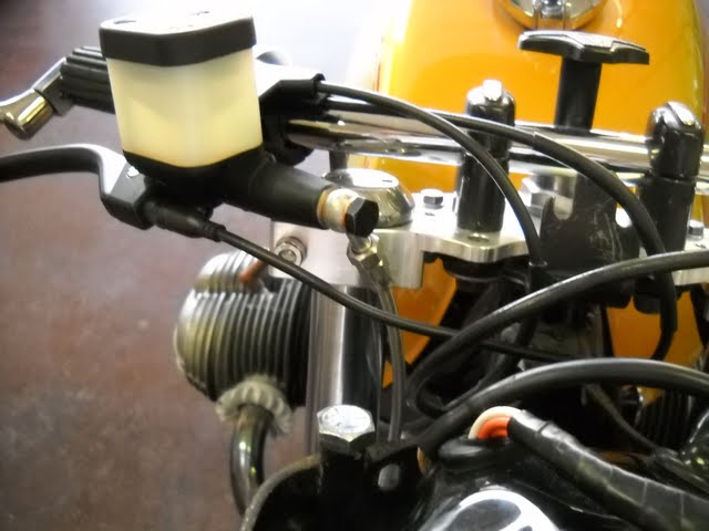

I would do away with the hard line and run stainless braided down to the calipers. Why have more fittings that you need? All you need is four fittings, not six or eight. I would run a double banjo bolt at either the MC or one of the calipers. I think they are easier to bleed running two lines all the way down. That's how I set up my R65. A brake line over the fender is a giant air trap.
I like Supershaft's ideas. Here's some pics of my brake hoses. One line down from the master cylinder to the right caliper...
Then one line from the right caliper, over the fender, to the left caliper...
Giant air trap, yes. To bleed the system, I removed the left caliper from the fork leg and elevated it during the bleeding process. Shown below is the caliper installed after bleeding. A pain to bleed? Not that hard to remove a caliper. Several inmates do the bench bleeding technique, elevating the calipers above the MC during bleeding.
Ray
ABC #12947
'75 R90S
craydds is offline   Reply With Quote
