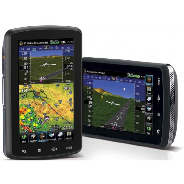

I think this maybe that new GPS..... garmin seems to always release stuff to aviation before automotive
Ben

Thanks, it's one of my favorites too.
Not sure if that's the same one. I don't know much about it except it's supposed to have a 5"x5" screen and a much improved operating system.
That looks somewhat like an aviation version of the Montana... Looking forward to seeing this Zumo 700 though; I always thought the Zumo line was too big (a 5x5 screen is pretty sizeable...) but if it includes all the maps... It may be enough to make me pick it over the Montana, even if I can't take it hiking and sailing with me as well.

Maps included is just rumor (as far as I know) at this point. I was told that Garmin releases their new product at a specific electronics convention in January every year. If that's true, we don't have long to wait
