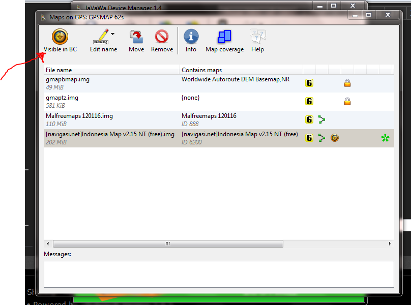

Hey guys - I have a basecamp question I was hoping you could help me with.
I'm in Indonesia right now and have a good Indonesian map on my unit, but I want to see the maps on a laptop I am using. I've downloaded basecamp onto the laptop, have plugged my device into it and can see my device and all my waypoints and tracks.
However I can't view the Indonesian maps on the big laptop screen.
I tried going under the view tab AND in the drop down menu but it just is not listed in either place.
I thought it was going to work when I used my device as a external hard drive. I opened it up, and had 2 folders; documents and Garmin so I clicked on Garmin:
When the folder opens I can see the file - "navigasi.net Indonesia Maps".
Clicking on it to open it I found the default program to open it was something called "Windows Disc image burner". I changed that program to BaseCamp, clicked on it, and it looked like it was going to open after "struggling" for a bit but then I got this message:
and it wouldn't open. The map is working great on my device, I just want to be able to see the map on the big lap top screen to work some routes. Sorry I should have said I'm using my 62s but posted here as this seems to get the most traffic. :)
Any help greatly appreciated!!

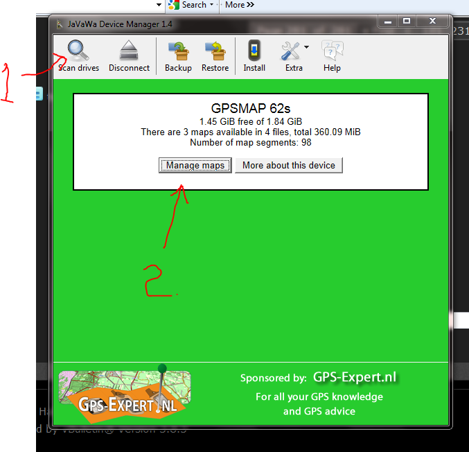

Atlas huge thanks - it worked!! And also thanks for the tutorial and links Embeedee!
For any other "techno-tards" like me reading this, here it is with pictures.
1. Download the link Atlas links to above - v1.4 is 2.93 megabytes (about 20 minutes download time on Indonesion broadband! )
2. This is the page that comes up when you start the javaWa program:
Mine didn't find my unit until I hit the "scan drives" button in the upper left corner.
From there I just clicked on the manage maps button and the following page came up with the maps on my 62s (I'm sure Montana would be the same):
I clicked on the map that I hadn't been able to see in basecamp before and then just clicked on the visible in basecamp button. The only catch was I had to shut down basecamp first. When I reopened it, it worked no problems!
One more question for you experts: Should my Indonesia map now be visible on all computers with basecamp when my unit is plugged in, or do I need to download javaWa on all the computers I download basecamp on?
(I like to travel light without a computer, and here in SE Asia, ever town has tons of "internet cafe's" where for mega cheap you can rent computer time with BIG screens!)

You should be good to go, the changes were made on your GPS.
Also, no need to download JaVaWa Device Manager on each computer. Just install it to the uSD card on your GPSr and use it with any host PC.
Likewise with BaseCamp. Just copy your BaseCamp program directory to your uSD card, and run from there on any host machine!
