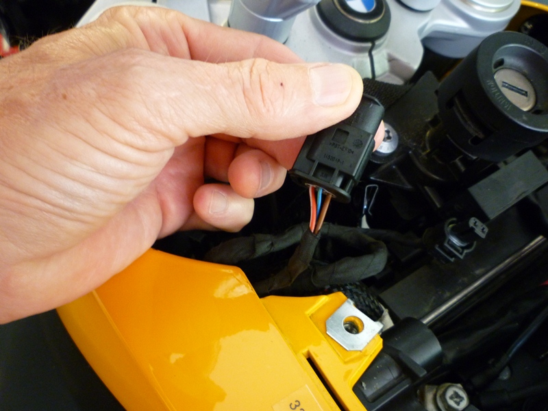

Hey All,
I haven't abandoned this idea. Just haven't had time to devote to it. I am convinced that it can be done, however, and that the GS can supply its own VSS signal to the Rostra unit. No external device needed.
Today, while installing a mount for my Zumo, I dug around a little under the battery cover, and voila! There it was: The 3-wire plug that will eventually supply the VSS. According to what I've been able to find out, the blue wire carries the VSS signal, but it must be connected to the 12v power supply on the same plug via a 300ohm 1watt resistor in order to supply a signal that the Rostra unit can digest. According to source, the VSS wire then generates approximately 5,000 PPM.
I have no doubt about the viability of this project. Once I get into it, I'll start a new thread to chronicle the whole process.
Here's the plug:
My Blog ----> http://soundquarters.com/bobsblog/
