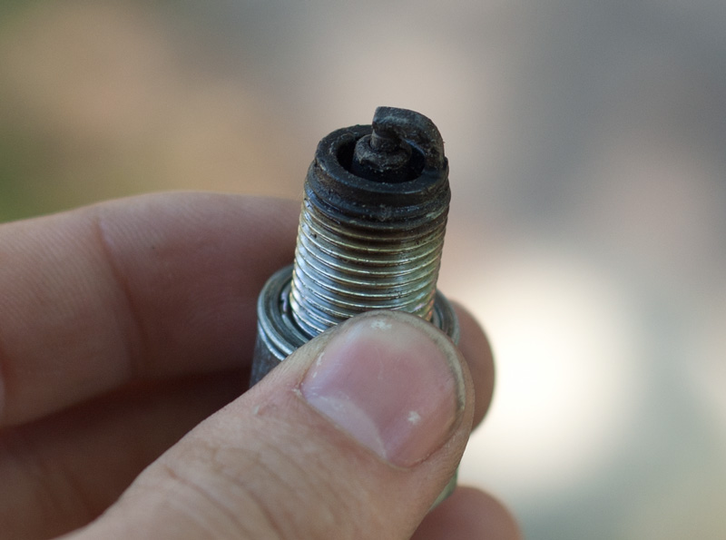

So back to the trip I just got back from.. the first few days up into the UP the sputter was regularly occurring every 30min to an hour of highway riding. The first 45min to an hour of the day usually had no issues though. Then after holing up at a cabin for 3 nights without riding, the sputter increased in frequency to once every 5 minutes or so. I thought maybe my airfilter had become clogged from riding on some dirt roads, and I realized I had never checked it. This continued until I got to Chicago, though strangely the last hour into Chicago in the rain on I-94 at 70mph was sputter free. Had a chance to do some maintenance in Chicago, and upon pulling the plugs saw that they were extremely dark with sizable deposits. Here's a picture:
My thought was that this explains my high oil consumption (in addition to pushrod seal leaks), and may be compounded by a rich running condition from the clogged airfilter, causing intermittent fouling. So I went down to Motowerks Chicago, which is a great place by the way, and got a new airfilter and showed them that plug. The fellow recommended some higher temp plugs, NGK BP6ES. So I installed fresh plugs and the airfilter, and when I took the old airfilter out I noticed... about half a cup of dog food under my airfilter inside the airbox. Which blew my mind. I've seen mice nests in airboxes before, but never with dog food and nothing else. So I thought some asshole had at some point deliberately put dog food down the air snorkel, but who knows, and I don't think it caused any problems. Just an odd digression for you.

The new plugs, with 300 miles on them look like this:
so it seems they're going the same way as the last plugs and oil fouling, though I should mention this picture was after idling for half a minute with the choke on and going up and down the street.
