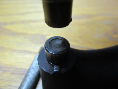

The proper tool from 1905,you can change the rivetting heads and there are some with more reach. But I still use that old one. Old time cobbler/harnessmaker ???
Leathercraft stores may just have a tool, all you need is a hammer and an anvil on the other side.Looks like this at the tip.
Anvil will work better if shaped like that, for that slightly rounded PRO look.

In plastics....or soft materials compression rivets are the best.They do not need much banging to set, just some light Tap Tapping with the right die tool not to flatten the head too much from its original dome shape.And even with metals they can sure hold up pretty good. I keep lots of then on hand in all sizes/lenghts altough if you are careful they can be cut down a little on a grinder. Solid brass ones are hard to find but they are out there, sure are in my friend's "cobbler supply" catalogues.
