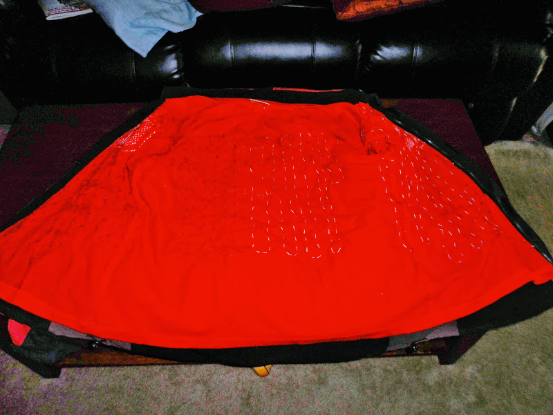

It's getting cold out there. I safety pinned my homade electric heat shirt into my riding jacket today.....and thought that some other cheap bastids might like to see how I made it.
For this shirt I made it from a perforated sports t-shirt, and cut it down the front so I could pin it into a jacket.
I either use 38 to 40 feet of 30Ga stranded copper wire (uses about 4 amps), or 55 to 60 feet of 26ga (uses about 5 amps). The pictures that follow are of the 30 ga.
Here's a good wire routing....

Show's short sleeve electric shirt pinned into my riding jacket.
From odds and ends
Shows wires run in left breast and safety pin method as well as electrical connection on left.
From odds and ends
Jacket with arms prepared to put jacket on. Good picture to use the zoom tool.
From odds and ends
Back section...use roughly 2/3s the allotted wire in front and 1/3 in the back.
From odds and ends

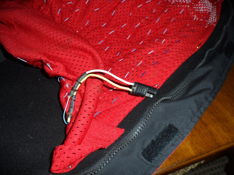

Electrical connection come out just to left of belt buckle.
From odds and ends
I securely sew the electrical connection to the shirt fabric. I use heat shrink tubing at the connections to the small wires.
From odds and ends
Remember the closer that your heat gear is to your body the more heat effect you get. If you wore a heat shirt in place of a t-shirt, you could stay warm with a couple amps or less if you use several layers on top of it as well as a jacket.
I like putting my gear between layers where it doesn't require a heat controller. If you have experience with placement...you can save yourself the cost of a controller.
