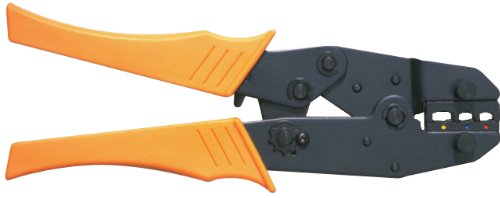

nothing wrong about using #two- i ALWAYS use 'em along with non insulated crimps ( the "insulated type are the cutise plastic jacked ones) this for work mostly ..as hobby i usually solder. with the longer handles these make the very best connection..simple and cost effective. i wouldn't even consider the ones in pic #1 that being said, they do very well at cutting small screws- right tool for the right job

I have the second tool pictured and it is excellent for uninsulated crimp lugs. If you will be doing any crimps with insulated lugs it is well worth buying a quality ratcheting crimper...I finally got one about a year ago and wish I'd done it much sooner, my crimps are much stronger and more reliable now. Ratcheting crimpers also have interchangeable dies for various types of lugs, insulated and non-insulated. The Paladin below is what I bought, was about $60 with one set of dies included...

That first crimper you have is junk, the second one is the one to use.

I would spring for the tool in the 2nd pic. I've got similar for home use It's a Klein J1005? overall length about 10". Has clean solid jaws and enough leverage for clean tight crimps. The one in pic 1 will work if it's all you have to get rolling again but it's pretty much a junk tool. For home use and quality crimps I use the Klein. I've got one of the cheap junk ones I keep in the tool roll for emergency road repairs, better than nothing. I don't care how much shrink tube or electric tape you use...a bad connection is a bad connection.
