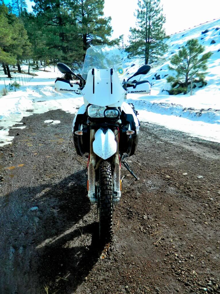

I took her for a ride today. I think she liked it!
Photobucket
Photobucket
Casejeep is offline   Reply With Quote
