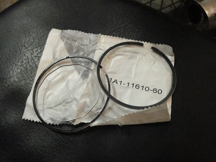

Today I put on the pistons and NOS needlebearings.
Then I saw the rings, a setup that I have never seen, so I don't know how it goes in. Anyone?

That kinky ring is made to go in behind the lower ring, and is meant to keep the piston centered in the bore. They're rubbish, and every time I've taken apart an engine that was fitted, they were broken in several places. Thinking of what a mess it would make if one of those pieces got loose, I can't bring myself to put the new ones in. I'm not alone in this, lots of people that know a lot more than I do omit them.
Great info! Cylinders will go on in a few days then :)

JC is correct. That ring often gets called an "expander ring". Lots more info if you search using that phrase - almost all of it will tell you to leave it out.
